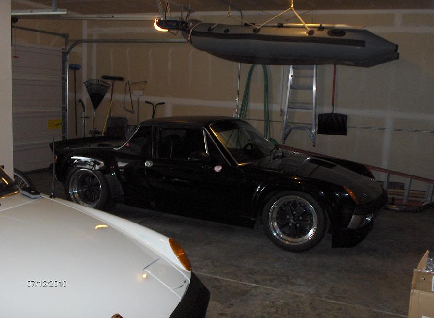

I did chicken out today, but plan on hitting it first thing in the morning. I have tomorrow off as well.
I did however bring home Ed's MONSTER 914-6. Haven't been behind the wheel in that for a while, felt good.

ya sure "Ed's" monster 914-6!!!!!

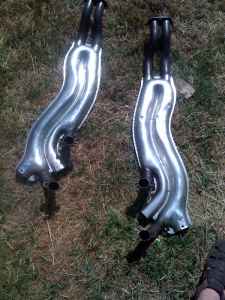

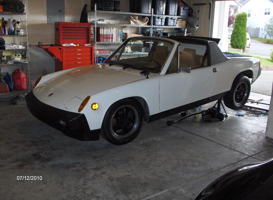

Picked these up over the weekend:
Going to start the tranny pull today, replace any seals I can and backdate the exhaust. I'm hoping to have everything done this week. It's raining today, but suppose to be back to sunshine tomorrow.

those SSIs along with a backdated muffler should help a bit in the power department.... (IMG:style_emoticons/default/biggrin.gif)
and the 1.7 and 1.8 exhuast parts always seem to be a little less expensive to acquire (IMG:style_emoticons/default/smile.gif)

QUOTE(DanT @ Jul 12 2010, 07:57 AM) *
Yup, it's already been determined the diameter of the pipes between SSI 2.0 and 1.8/1.7's are the same, but I think I'll actually like these better. The muffler will sit up a little higher (less visible).

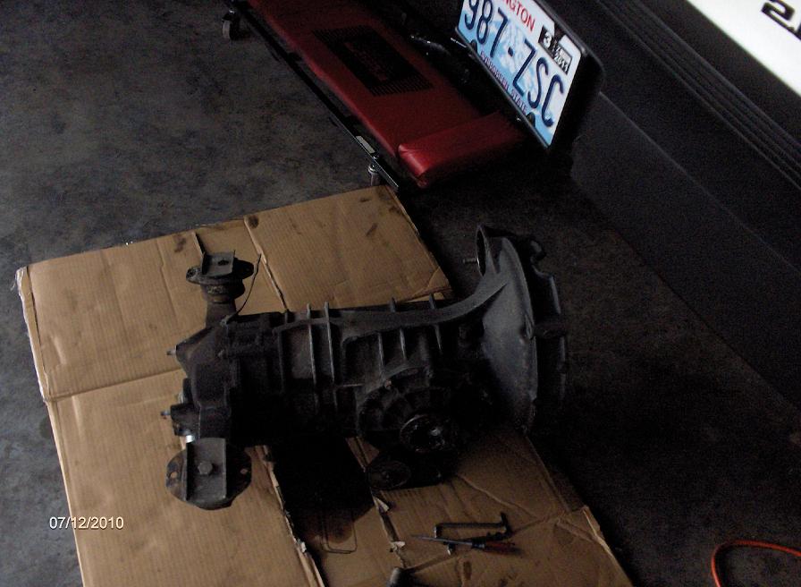

Pulled the tranny out a couple of days ago. Leaky little bastard. The main seal almost crumbled when I took it out.

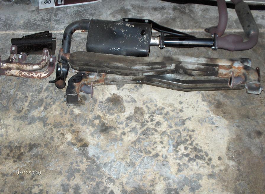

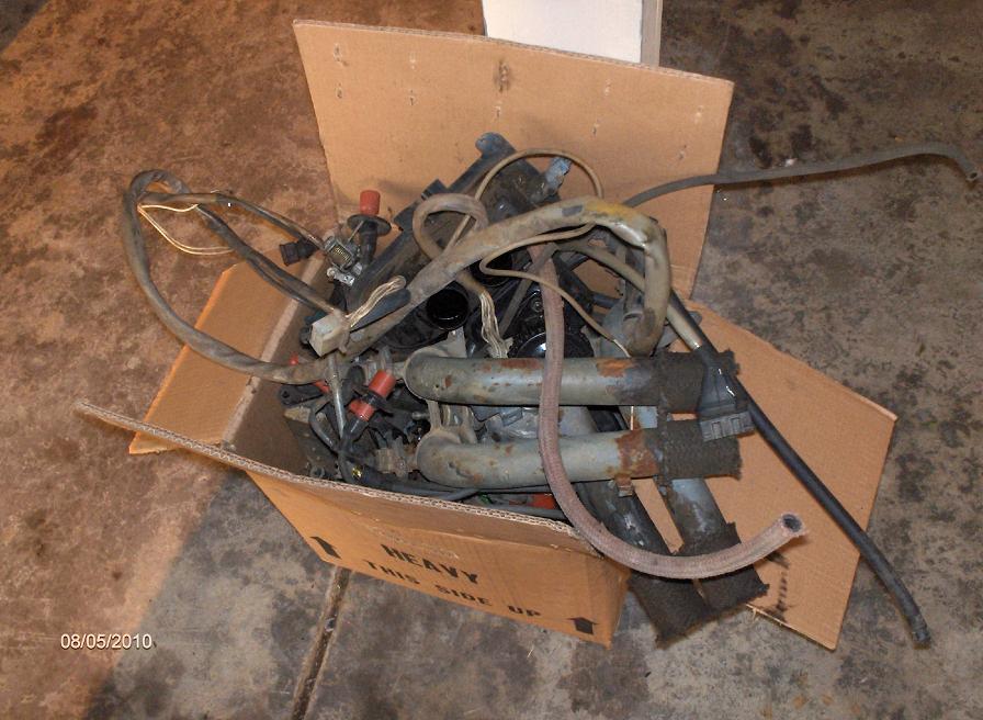

Not planned in this little project, but a set of SSI's came up locally so onto converting the system to pre 75'
I never really paid attention, but the later stuff sure does wiegh a lot.

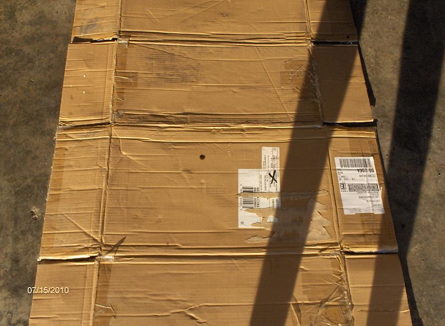

The cardboard test from the drive yesterday, proper heat cycle, got out this morning and noted only this on the clean sheet of cardboard.
SWEET!
No more tranny leaks!

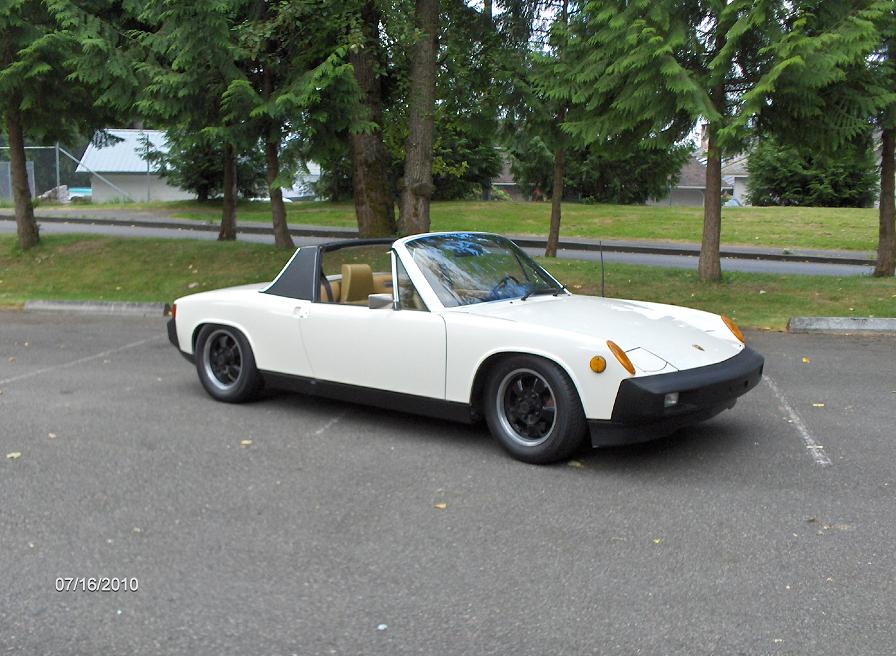

Took the 914 out for a drive around the lake this morning. Very nice out, gonna hit 77 today according to the news.
My opinion on the backdating of the exhaust:
It's worth it in the end, you loose wieght, get a little "seat of the pants" power and with SSI's, clean heat.
The only downside of the system is the volume of noise it makes. It's frankly annoying and raspy. The 75-76' systems are so quiet compared to early SSI's and crapy Bursch headers/muffler.
I know I'll swap that header out for something else, but for now, it's just drive the 914 the rest of the summer.

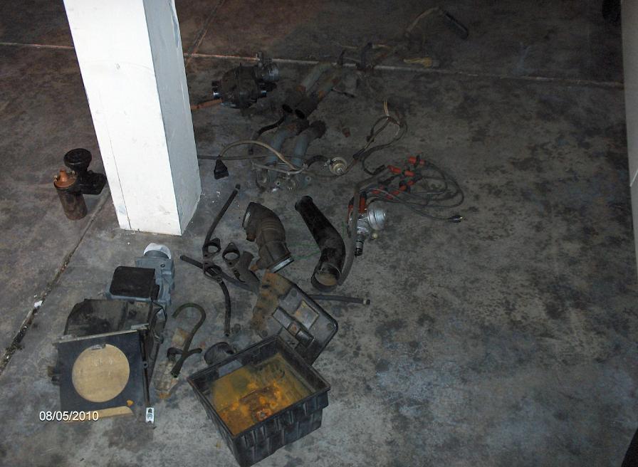

The ethanol they are putting in the gas right now is killing me.
I forgot to put in my couple ounces of stable and made it about 100 miles before the carbs started clogging up again.
Sweet.

Box-O-Ljet
Decided that D-Jet was just too much pressure for me. Gonna go with the flow this time around. (IMG:style_emoticons/default/biggrin.gif)
Less "stuff" to the system, that's for sure.

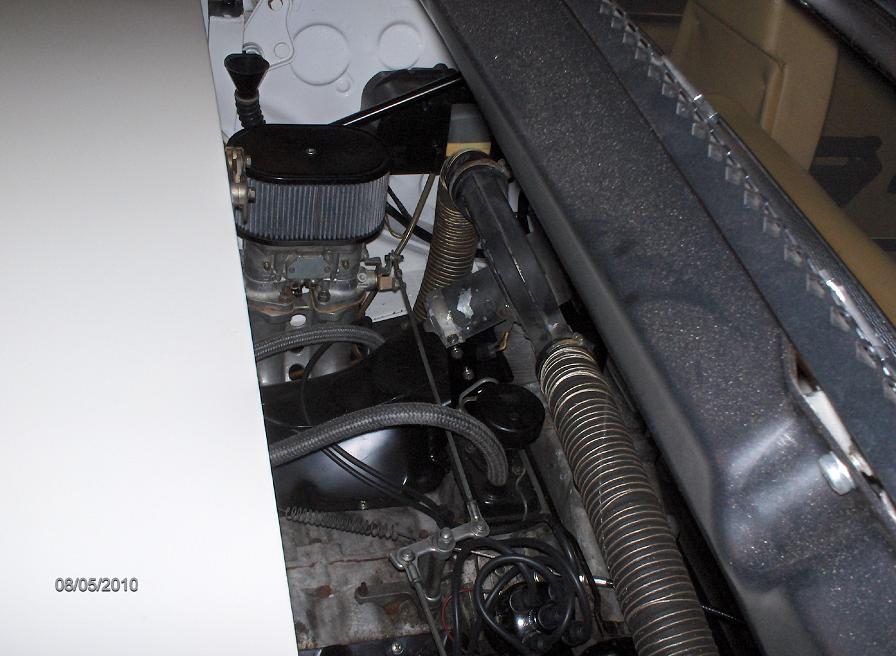

If you look closely, you can see my support brace by the circut board. I test fitted the aircleaner bracket, looks like that won't be an issue.
The cool center heater fan will be though. I'll have to put back in the original single outlet fan that mounts under the board and aircleaner.
Not a big deal.
Time to source parts, gaskets, lines, hardware and some 912E injectors.
Hey Rich, if you see this, my 75' already has from the factory the threaded bosses for the aircleaner bracket. Also cool and makes sense they'd be there.
