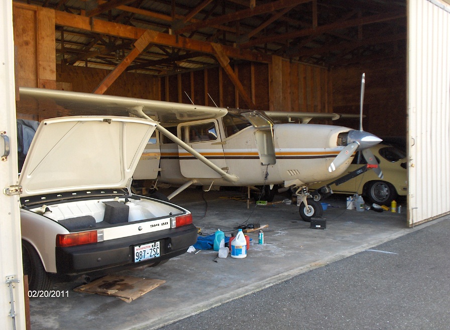

914 has been sitting in winter storage for about 3 months. This weekend was cold, but very clear skies and sunny. So the wife and I headed up to the storage hanger and dug out the 914. We put almost 200 miles on it over Saturday and Sunday. It felt nice to drive a 914 again. I snapped a quick picture when we brought it back to the hanger.
I can't wait until spring to start driving it daily again. (IMG:style_emoticons/default/driving.gif)

Dan, do tell about the hangar.
A great friend of mine had a sweet hangar at the Arlington airport. I'm guessing that's near to you.

My buddies place at Skagit, I don't get any stick time behind fixed wing anything these days (Too much $$$$!). He's got some cool ground-based toys I get to pilot once in a while though. 59' Vert-D, the yellow 65' C you can see in the picture and a handful of VW bug's from the 60's and 70's.
It's a really nice drive up to Skagit and once we're there, we usually spend the day up there. Visit Camano Island, LaConner etc. Makes for some great little towns and cool twisty roads.

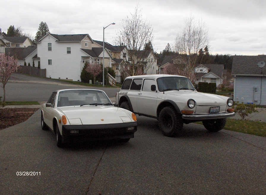

Interesting, one year later and I still own the 914. Odd.....for me anyway. (IMG:style_emoticons/default/blink.gif)

Seems like a long time (IMG:style_emoticons/default/happy11.gif)

If you (when you) decide to sell that VW....consider me interested.

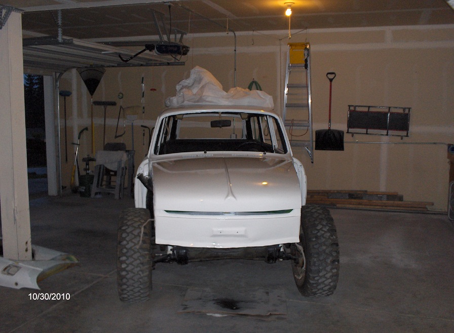

I have a thread over on the samba about the Monster Squareback if you want to read up more on it. There is a small line of folks that want it. I'd be kinda foolish to sell it becuase I would just try to replace it with something similar. i.e. aircooled off road rig like a Thing or Class 11 bug or another T3 etc. So I'll probably just keep it.
Here's a shot from painting it last fall:
