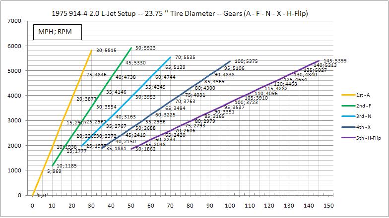

This is a better chart for the gears to show how much difference the X and flipped H gears make. I'll print and file this one in the "Stuff I've done to the 914" folder:

This is very interesting. I've always found 4th and 5th to be disappointing for how high they rev at 50-70mph. How common is it to change out the high-end gears like this? Any issues to be aware of?

QUOTE(mburkhart @ May 18 2011, 07:43 AM) *
I have been warned by some that turning such low rpms at higher speeds will increase head temps. Makes sense and is probably very true. I think one of the key factors to making something like this work is having a tall enough 4th you can run at 60mph if needed (for hills and such) and having a healthy, torque filled engine.
I have a stock 2.0 with L-Jet and would put money down I produce more torque than a stock 2.0 with D-Jet. I also don't run 205 steam roller tires. I stick with 185's pumped to 40psig to reduce my rolling resistance as much as possible. Given all that, so far, so good!
Loving this combo, simply loving it!
It's so nice blowing by people at 75mph and only turning 2700-ish rpms.

QUOTE(Root_Werks @ May 16 2011, 12:46 PM) *
Where's the rest of the chart? I have a flipped H and a 6850 limit.

QUOTE(Root_Werks @ May 13 2011, 07:23 AM) *
Using the tools from 914world, here is the stock gear chart with my current size tires:
Maybe a dumb question - but if redline is at 5600 rpm, why do these charts stop at 5200?
... and if it went to 5600 on your current tires or stock 165HR15 tires - out of curiousity what would it top out at mph?
I ask because I've had my dead stock 73 2L on 165s up to 126 mph on the speedo (stock speedo error of +/-5% aside) back in the day.

The chart I made is off the spreadsheet and I adjusted the formulas to display only what I wanted. i.e. were I think I would max my rpms and shifting for each gear. So 1st and 2nd might get close to 6k rpms, but 3-4-5 are not much about 5200 rpms.
Chart made just for me. (IMG:style_emoticons/default/biggrin.gif)
