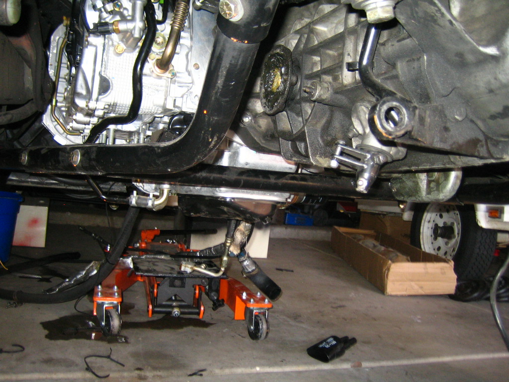

WOW! doesnt that EZ30R look like it was made for that engine bay?? FITS like a glove!
Renegade Hybrids Engine Cradle works with this engine also, lines right up with motor mount position.
See pics. It will be about 1.5 inch higher in engine bay. Still waiting on motor mounts, temporary smaller spacer in place of mounts.
This is just a mock up, Have to pull back out to put flywheel on. (being resurfaced)

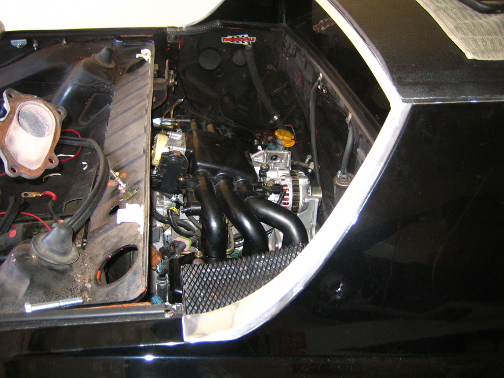

look at all that space around throttle body!

as i stated earlier, engine will be about 1.5 inch higher, but look at where it is now. NOT bad. When mounts come in I think it will be perfect!

on cradle

Here is a pic of where the motor mount lines up, waiting on mount to come in mail

side clearance

passenger side clearance

Fits like a glove. Stock Subaru mounts fit right into the holes of the renegade mount. Only mod was to made the holes slightly wider on the mount where the mount bolt comes through. The 3.0 liter mount had the 2 studs on the mount a little closer together. But same angle, and slipped right into the 2.0 mount location! Sweet!

The oil Pan is Perfect. Great clearance !

side view

final position of intake, yep slight mod needed to rear firewall, but maybe i might be able to slip a 90 degree Coupler in there.
I like that you can see the Spider intake real well.
