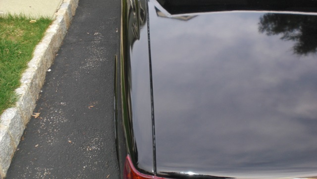

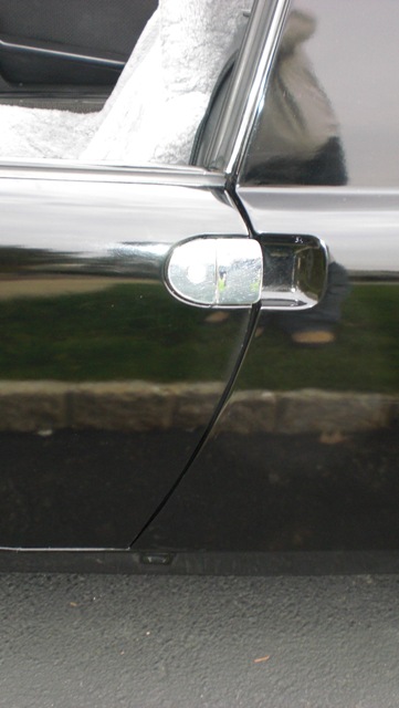

I'll start with the good:
The lines of the car were great. Nice and straight.
Passenger side

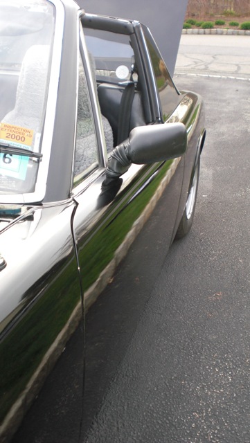

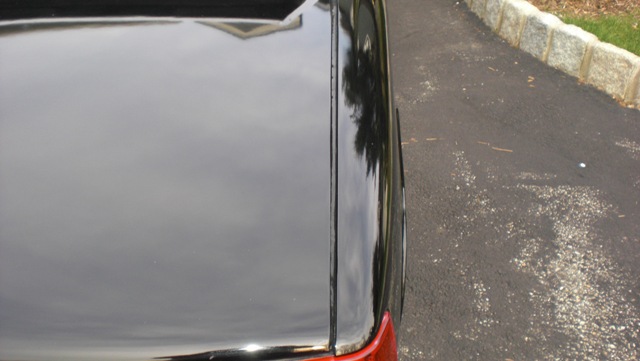

driver's side lines:

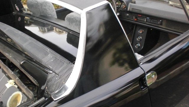

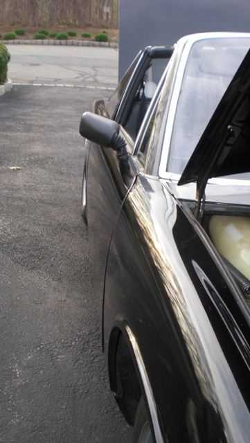

driver's side sail also replaced:

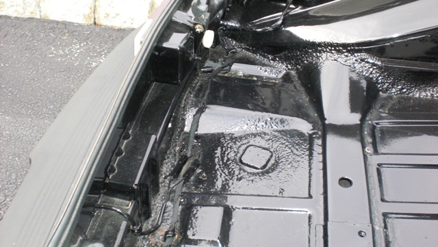

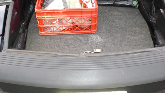

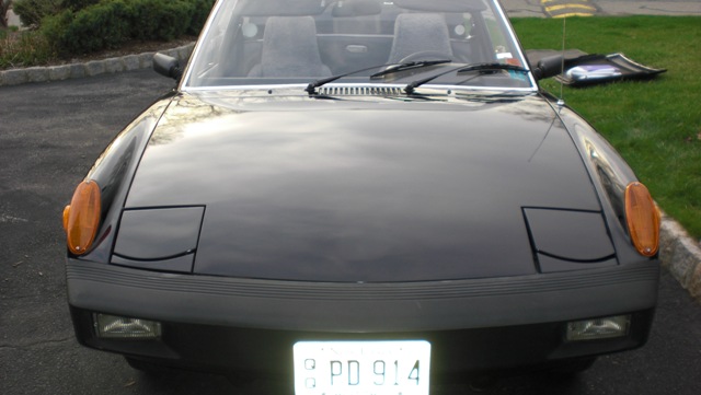

both front and rear lids opened and closed nicely:

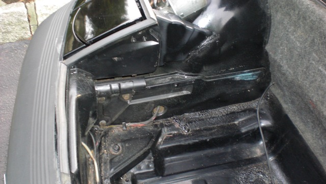

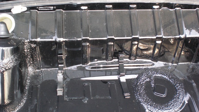

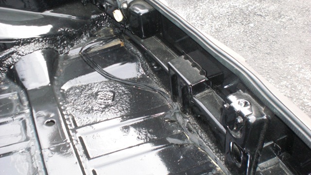

all rust was repaired in the trunk:

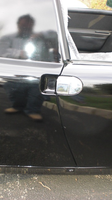

he mentioned the longs were replaced; the door gaps look good:

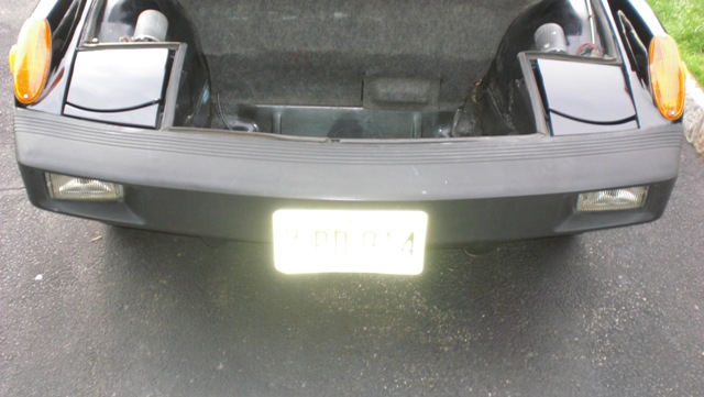

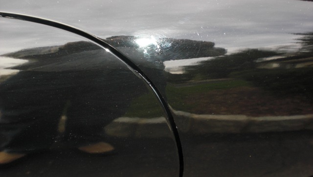

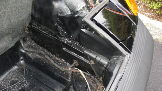

the front bumper guard looks a little weathered, could just use a little TLC and the gas tank area is pictured:

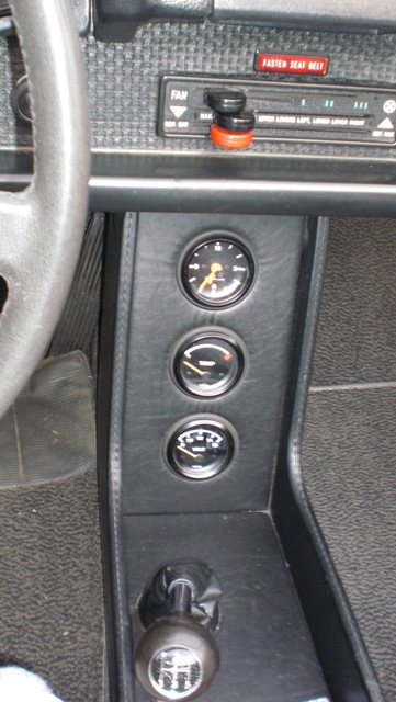

the nicest thing I could point out in the interior is the console, looks great and in working condition:

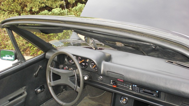

...maybe one more nice thing...the taga seal is in good shape. But also in the picture is the dash. I've never seen one of these dash cover ups, but it's certainly a strange and cheap feeling fix. You can't tell from the pic, but it's flaping around (needs to be glued)...but looks good for a few feet away. And the vinyl forward of the pad is dry and weathered.

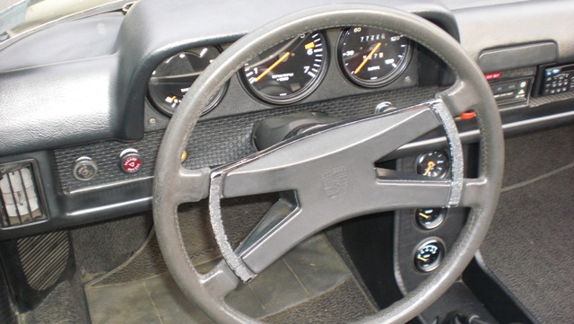

the steering wheel felt like a dead snake....it also had some other issues. The "column" had verticle movement. Not just quarter of an inch, this thing was moving up and down!

again...for the price, there was too many imperfections:

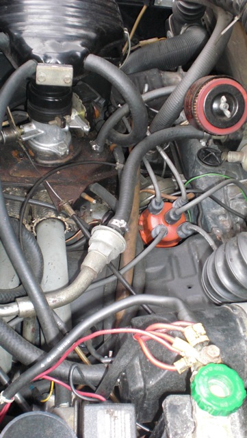

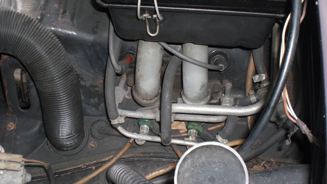

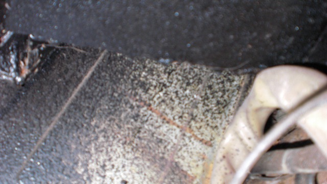

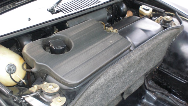

The engine bay's on these '76 amaze me....10 pounds of poop in a 5 pound bag. Really makes it tough to see what's going on.
Over the past 2 years checking out cars for buyers (PPIs), I've seen some nice engine bays and some that do not warrent a 10K price tag.
passenger side hell hole. Seemed solid
rmital

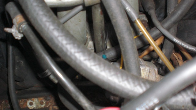

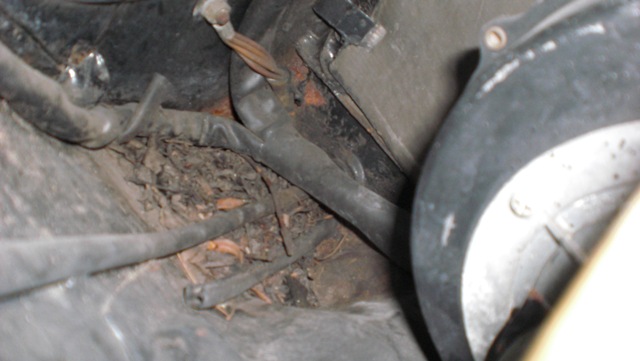

I couldn't get to the driver's side hell hole cause of all the smog stuff in the way...but here's the best I could do. I'm pretty sure I believe him when he said all was repaired:
rmital
post Apr 7 2010, 07:06 AM
Northeast optimist
Posts: 1,954
Joined: 12-December 05
From: Park Ridge, NJ
Member No.: 5,268
not the worst engine bay I've seen, but too much rust on the plenum, engine shelf, etc. for the asking price.

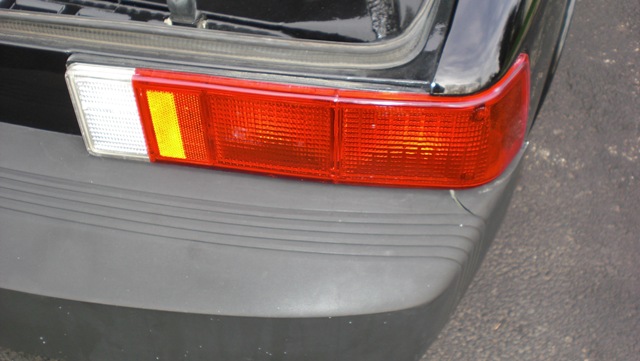

just some misc. stuff:

floor pans solid

rear suspension mounting points good
a-arm mounting points good
front trunk floor good
seat mounting point (couldn't move seats well enough) but all seemed well
