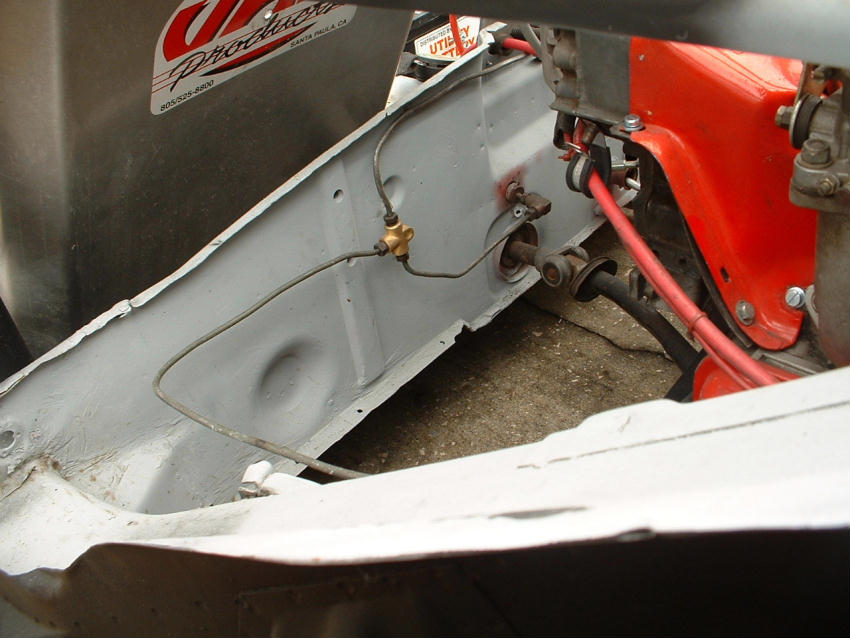

Take the P-Valve out and put in a tee from a VW squareback....go with a new 19mm 911 master. They are cheap.

As Mr Suave said........

Just curious . . . what EXACTLY do these proportioning valves do? What happens if you eliminate the valve (as shown in the pix posted by URY914)?
Joe Bob
post Apr 11 2010, 06:30 PM
Posts: 17,427
Joined: 24-December 02
From: Boulder CO
Member No.: 5
65/35 or thereabouts bias to the front. Keeps the rears from locking up before the fronts, which is a BAD thing. Removing the valve brings it closer to 50/50 as the front brake pads are larger than the rears.
Going to bigger calipers on the fronts is good thing with the valve removed.
McMark
post Apr 12 2010, 12:35 AM
914 Freak!
Posts: 20,180
Joined: 13-March 03
From: Grand Rapids, MI
Member No.: 419
Technically speaking, it doesn't proportion anything. It's a limit valve. It keeps the pressure that's going to the rear brakes from rising above a certain level, whereas the fronts are free to keep rising. At low brake pressures you have the same pressure at the front as you do at the rear. A true proportioning valve would mean less pressure to the rears even as low levels.
