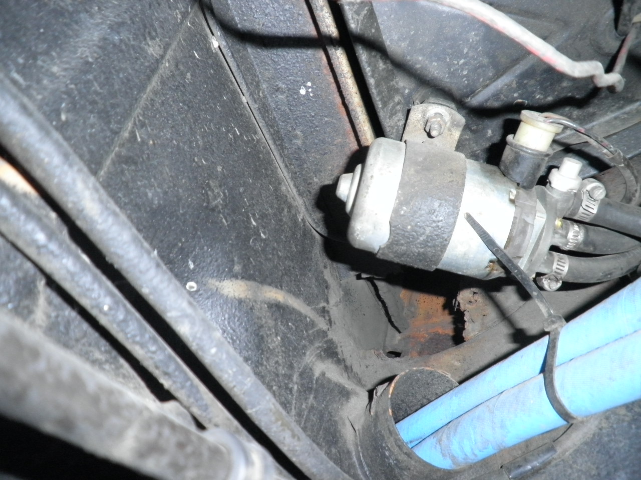

I'm considering buying this car. It leaks a few drops of oil when it sits overnight, the heat has been removed but he has all the parts -- i'll put it back on.
Scroll down for all pics.
Please opine... (IMG:style_emoticons/default/popcorn[1].gif)

Tom_T   Rob, That looks like a possible rust problem up b...   Apr 12 2010, 05:47 PM
rwilner   Rich, That looks like a possible rust problem up...   Apr 12 2010, 05:50 PM

jasons   I see red flags. The clutch cable is "bailin...   Apr 12 2010, 05:51 PM
rwilner   I see red flags. The clutch cable is "baili...   Apr 12 2010, 05:58 PM
jasons   Yes -- suspension ears (both) were welded by Race...   Apr 12 2010, 06:01 PM
SirAndy   As for the clutch cable, I'm not familiar wit...   Apr 12 2010, 06:02 PM
SirAndy   The hell hole is rusted, your fuel pump mount has ...   Apr 12 2010, 05:54 PM
rwilner   The hell hole is rusted, I can't tell that ...   Apr 12 2010, 06:10 PM
dlee6204   The car is going to need some work to make it righ...   Apr 12 2010, 05:57 PM
rwilner   How do you expect to add heat with headers and t...   Apr 12 2010, 06:00 PM

McMark   The number of 'oddities' would make me ner...   Apr 12 2010, 06:13 PM
rwilner   if price is right, it doesn't look horrible. ...   Apr 12 2010, 06:20 PM
McMark   The right price depends on too many things. I...   Apr 12 2010, 06:28 PM

Racer Chris   Pictures of the floor inside the car don't tel...   Apr 13 2010, 08:35 AM
jaxdream   I agree with Chris about the floor and tar boards ...   Apr 13 2010, 09:02 AM
dangrouche   For $5k, too much. It is clean. It looks to...   Apr 13 2010, 09:48 AM
