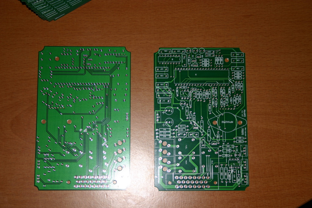

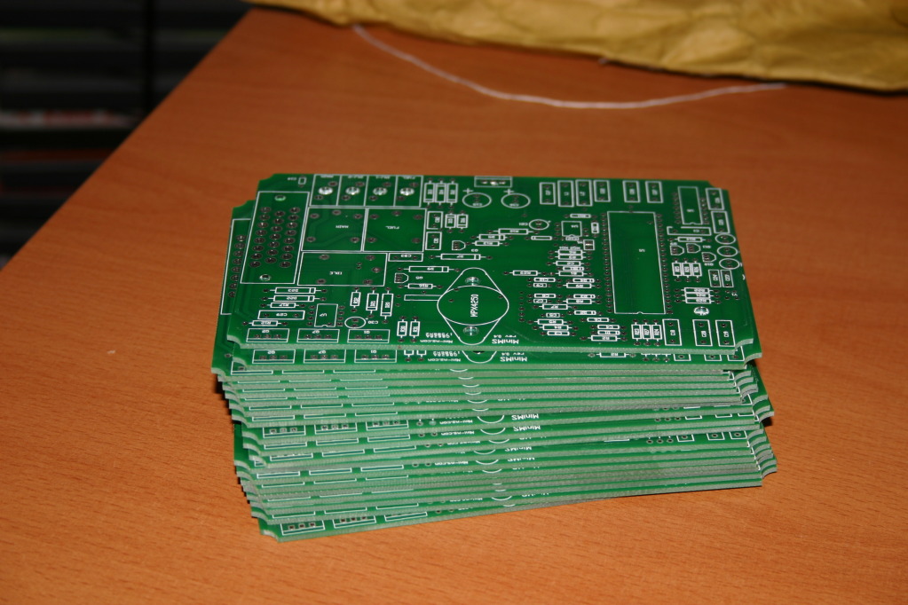

mightyohm   Can you post some pictures of the boards? I'm...   Apr 12 2010, 08:38 PM
JamesM   Can you post some pictures of the boards? I...   Apr 12 2010, 08:42 PM
JamesM   Ill post some pics of what i am playing around wit...   Apr 12 2010, 11:55 PM

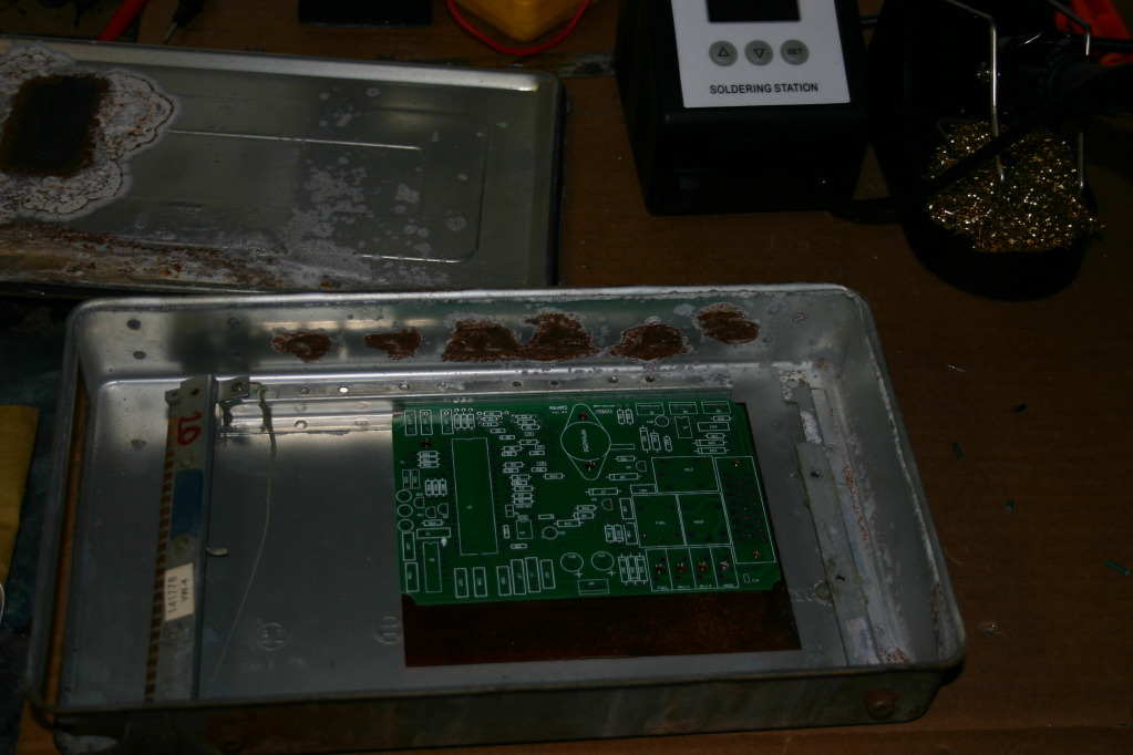

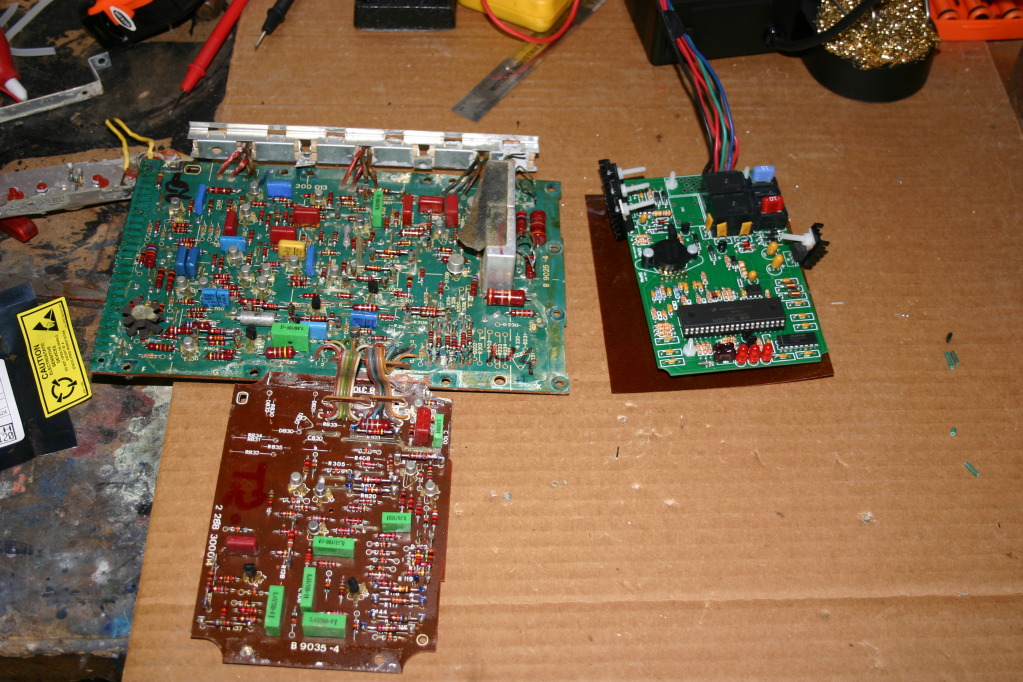

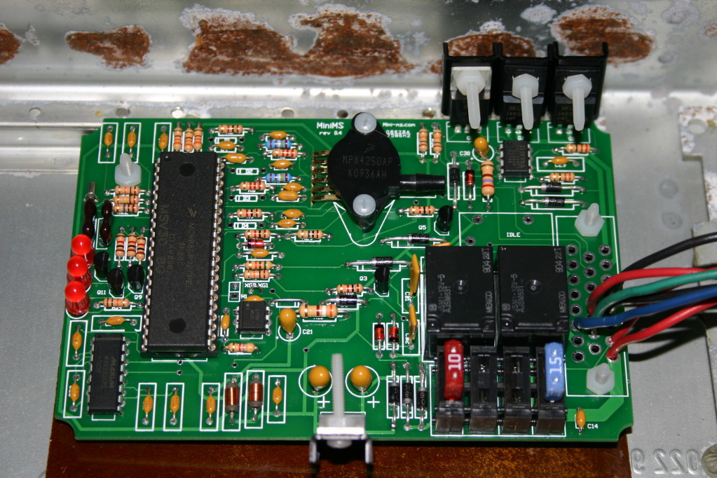

JamesM   Thought I would through in a quick update on the M...   May 3 2010, 03:54 PM
JamesM   A couple other smaller issues i need to investigat...   May 3 2010, 04:17 PM
JamesM   A few pics up for fun.... This is the box curren...   May 3 2010, 04:49 PM
