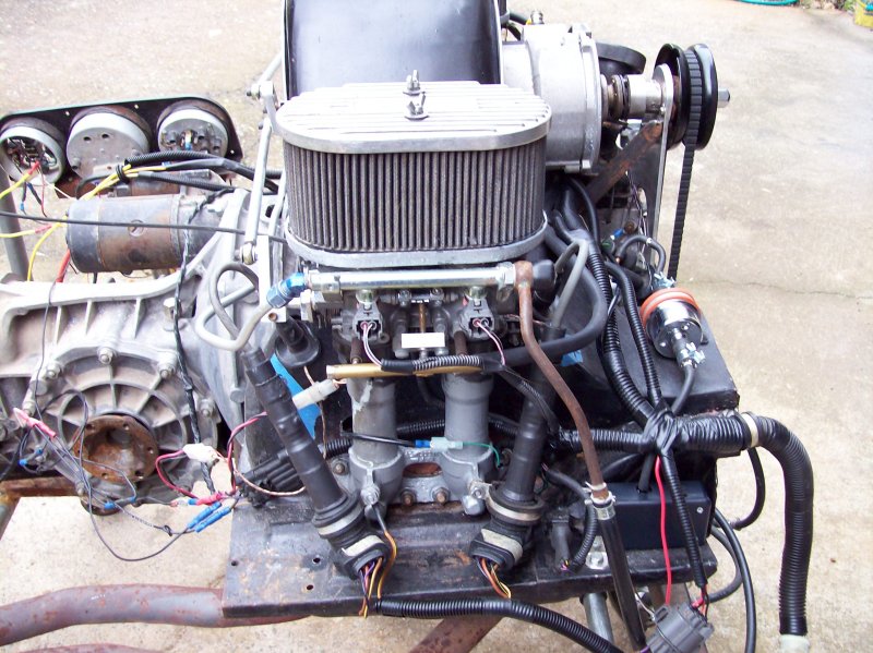

I,m running MS1 extra with wasted spark (VW Coil packs), Honda 900CBR throttle body's, 36-1 tooth wheel , added extra map sensor for barometer correction and O2 sensor.Here a picture of my setup.

That is a pretty intense looking setup you have there. What do you mean by changed every time you run your engine? is the MS just not holding the data or is your engine wanting different values every time you run it?
Having to change your timing around every time you start the motor is pretty scary. I have not run a 36-1 wheel so i am not familiar with the settings involved with it but i would go over them again very carefully.
Changing the timing is going to affect what fuel the motor wants so the two issues could be related... or not. I have heard of people having a hard time tuning ITB setups using speed density due to the vacuum characteristics, so that could be an issue as well. Where are you pulling your MAP signal from? Where is your IAT sensor located? You have a lot of variables there that makes troubleshooting a bit more complicated. This is one of the reason i try to keep it as simple as possible,
If you could, i would go back to a stock dizzy setup just to make sure you can get it to fuel correctly with the intake setup you have. Hopefully narrow down where your problem is coming from.
