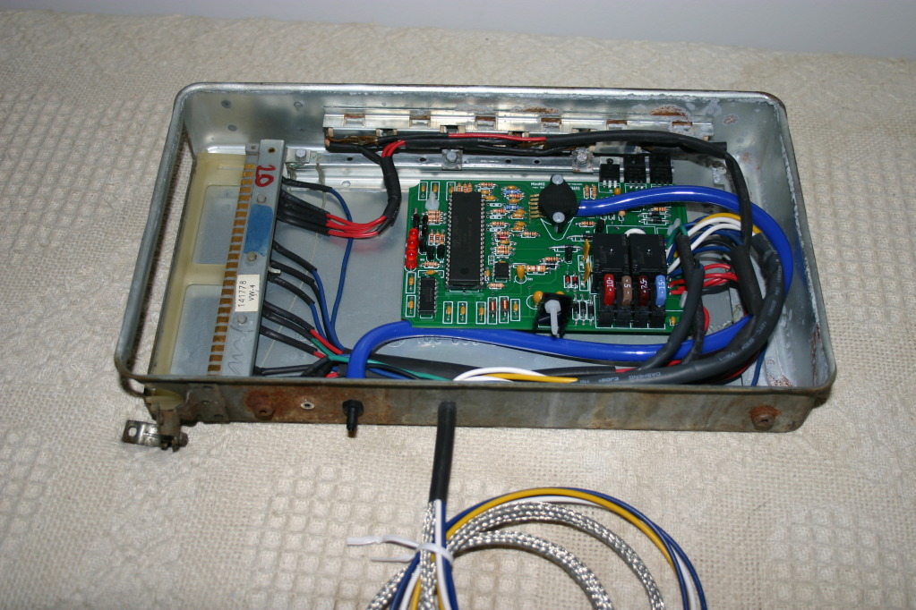

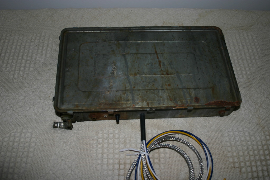

A few pics up for fun....
This is the box currently in my test car. The extra wires are to run things like my wideband 02 and ignition control. When stuffed behind the battery it looks stock. I have not got around to blasting and painting the exterior yet.

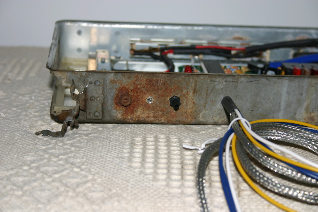

3/32 jack used for programing. I wired it up to use the cable from the LC-1 wideband, its a nice, small, hidden connector. next to that is the MAP port, and then all the wires to run the "extra" stuff i have on my car.

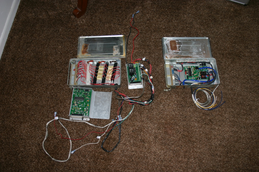

compairson of the MS2.2 system i pulled out to my new system that went in. I never intended the origianl system to say in as long as it did as it was pretty much hacked together for testing purposes. Still works great though.
