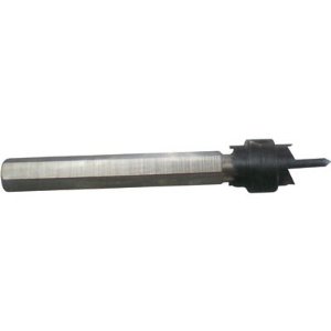

I have been drilling spot welds as I work on my car and it occured to me that there may be a better way (or maybe I am being to picky). I am curious what everyone else uses.
I have been using a spot weld cutter. It looks like a short drill bit with a pilot point and little cutters along the edge. It will cut through the top layer or steel but not the back layer (usually). They will cut about 10 welds before being hoplessly dull. When I was buying them at $5/bit it was fine but that company went out of business and the ones I find now are $25/bit. Are these the right tools to use or should I be just using a drill bit allthe way through the weld.

I use the solid type spot weld cutters. These are much better and last much longer than the 'tiny hole saw type'. I got 5 for about $12 on ebay.
The kind I have been using us the solid type. I have actually never seen the two piece version. I can't actually find them on Harbour freight but I will check e-bay.

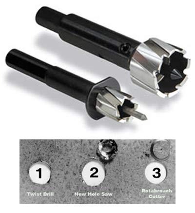

Just my .02 but I have drilled hundreds of spot welds with the smallest size of these (5/16" i think) from the set I have and it is as good as new. Cut steel like butter! Blair Rotabroach.

When drilling, I use a 3/8" Blair Rotabroach. If you do not use cutting oil they will dull within a handful of uses. But if you use cutting oil they last quite a long time.
As much as I love the Rotabroach, I also grind down the spot weld and pop apart and sometimes just drill straight through using a regular drill. It just depends upon the situation.
