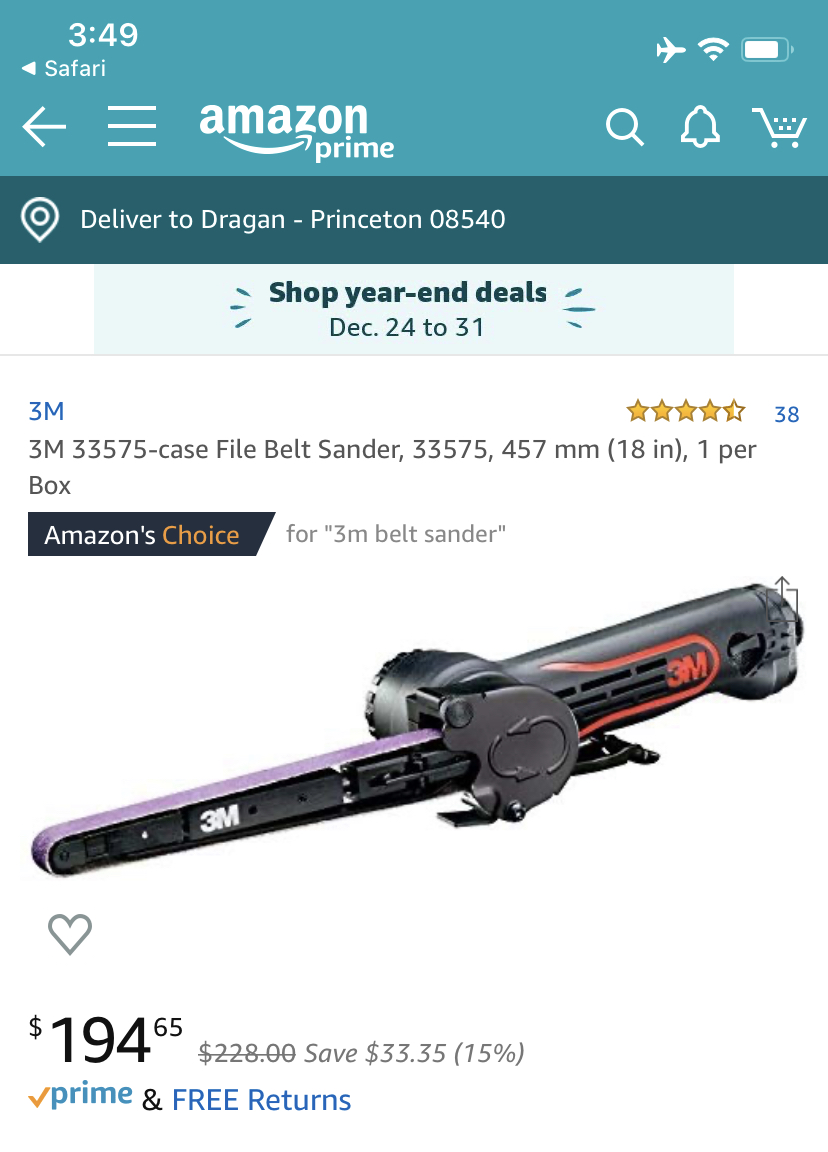

I have used HF and quality spot weld drill bits and didn’t really like any of them.
My buddy, who is working in a body shop, got me a narrow small belt sander with
60 grid paper and it works like a charm. Takes less then 30sec per spot.
I have a 3m but I’m sure any other quality tool will work.

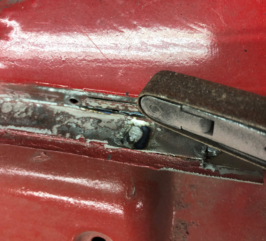

Click to view attachment..I like this - are you using this sander to go completely thru, down to the base metal ? Nothing else required?

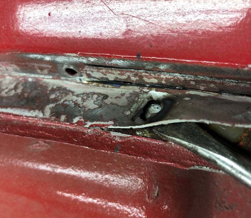

also prefer to use a small belt sander. Grind away until the metal turns blue around the actual spot. Then it is thin enough to just pry away with a screwdriver or similar.
Click to view attachmentClick to view attachment
