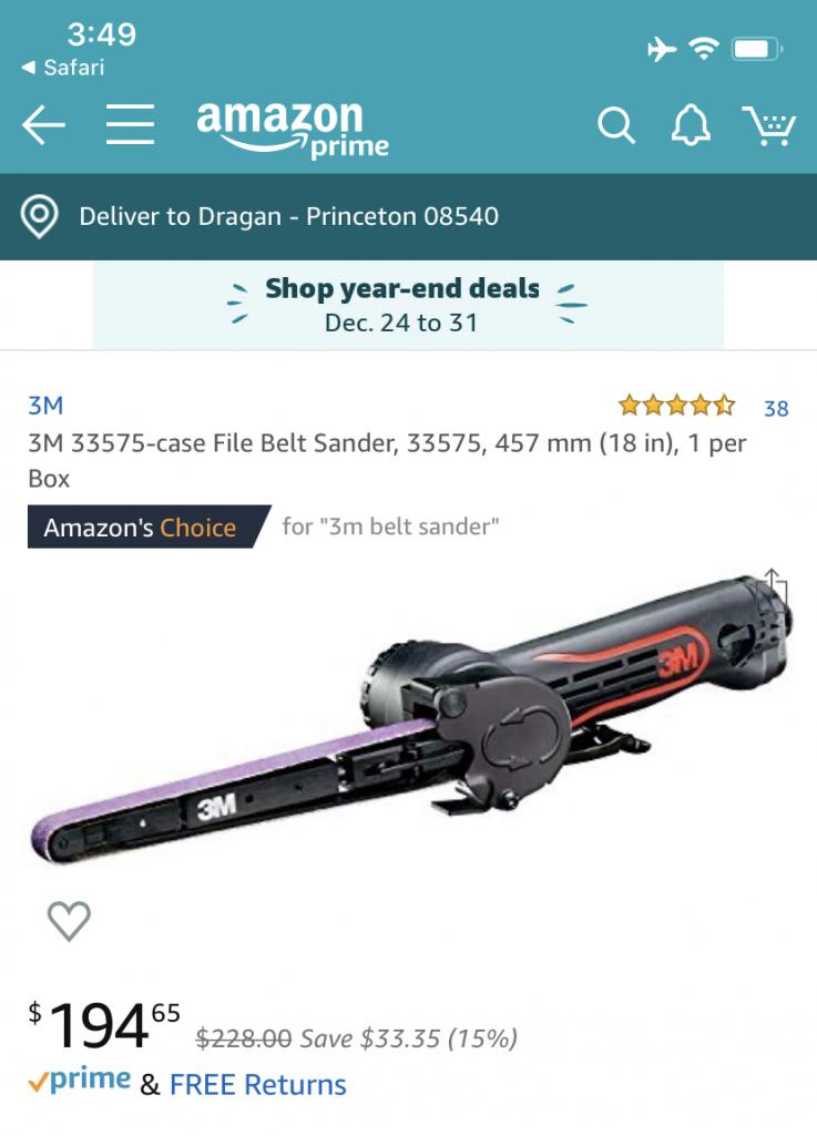

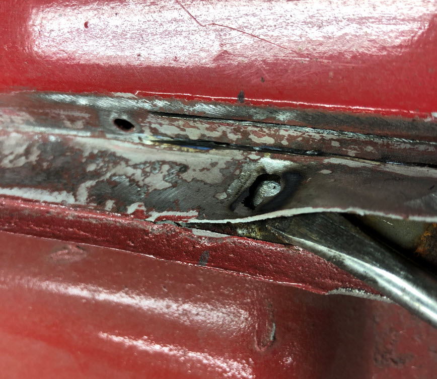

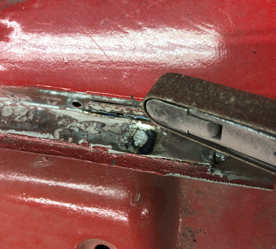

I have used HF and quality spot weld drill bits and didn’t really like any of them.
My buddy, who is working in a body shop, got me a narrow small belt sander with
60 grid paper and it works like a charm. Takes less then 30sec per spot.
I have a 3m but I’m sure any other quality tool will work.

QUOTE(draganc @ Dec 25 2019, 03:30 PM) *
..I like this - are you using this sander to go completely thru, down to the base metal ? Nothing else required?
