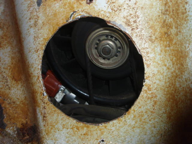

Working on the 914 again, and was making room for an EMC so, I removed the backpad, and this is what I found.
Well, I had seen the panel from the engine compartment, and knew it was there.
So, here's the hole:

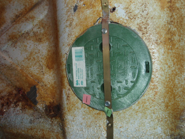

And the cover, WTF? Farmer bob did this one?
Ok. It works, and I am not the best craftsman, as I have done a couple of, eh, quick-fixes for a problem, which I fixed later.
So, put it back? Rather not. Any ideas?
-- brett

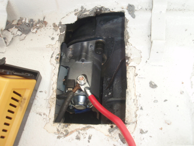

BTW, the PO also put an access panel in for the starter.
This will be used for the remote battery. I will clean up and make something for it. The battery cable is temporarily there...

Mark Henry   Many /6 guys cut a hole there so they can set the ...   Apr 17 2010, 06:43 PM
bfrymire   Many /6 guys cut a hole there so they can set the...   Apr 17 2010, 08:05 PM
