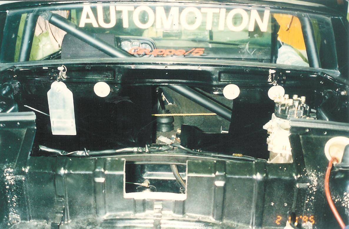

Attached ImageThis cutout was made for the horizontal fan bi-turbo in the black six. There is enough room for timing, alternator adj., wiring access and distributor removal.
A new sheet metal cover ( same contour as orig. shape) was fab'd and installs with sheet metal screws.
I like the green coverplate "John Deere" look !
Marty
