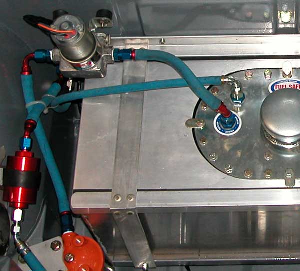

You have to use the socketless ends with only the correct hose. The long barbs and the precise fit holds it all together, no clamps or hacksaws.
I'll be re-routing these fuel lines soon but this is what they look like.

Aeroquip already did that.
Assembly rated at 300deg continuous at 250 psi.
The AQP has the same temp rating but a much higher pressure margin, 500 => 1000 psi.
Jake said he has seen 300psi on very cold startup but I think the socketless is probably OK for a racecar, maybe not for a race airplane.
