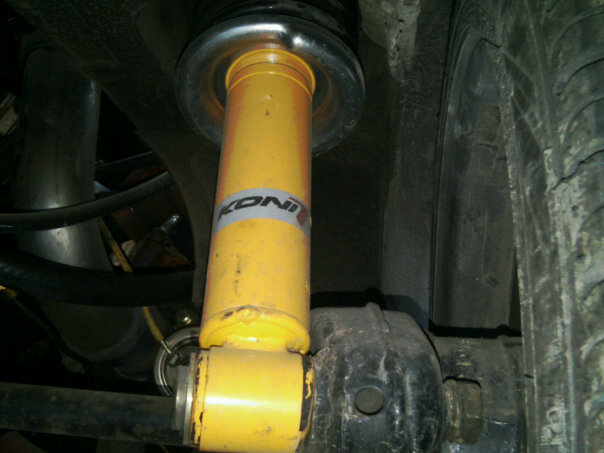

I don't recall any "T" ?
do you see it in the pictures of my Koni Yellow?

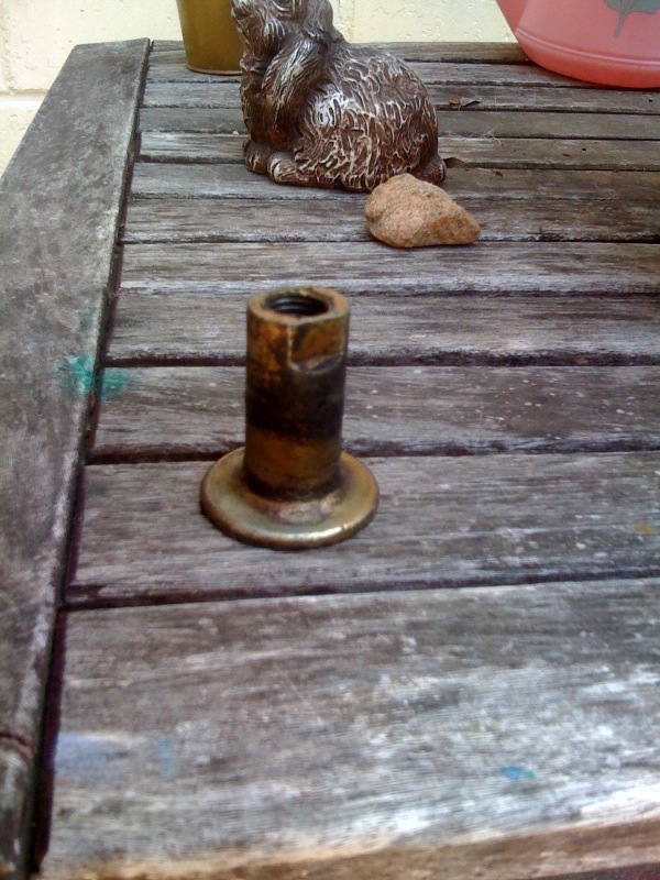

This is the piece...

QUOTE(yeahmag @ Apr 24 2010, 04:55 PM) *
I had to order that piece from Koni.... same issue, all the way from germany, but only took a couple weeks from ordering direct through Koni NA

I had the same issue when I installed these....
I retapped the aforementioned piece and then found two new nuts with the correct thread for the top...
Worked fine..

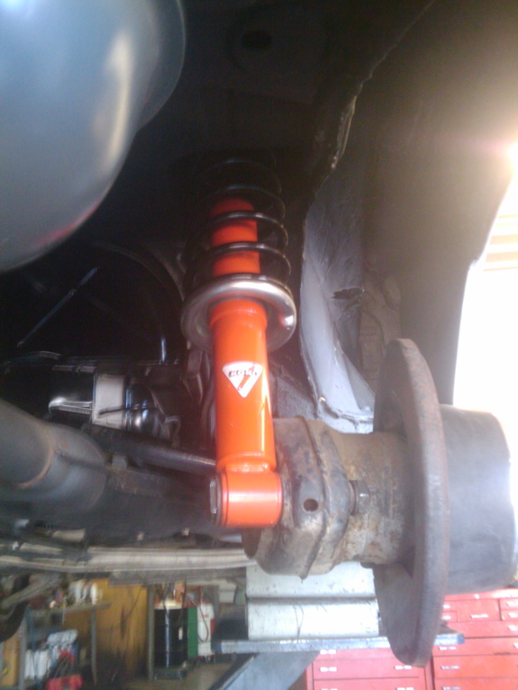

Eric_Shea
post Sep 2 2010, 08:40 PM
PMB Performance
Posts: 19,304
Joined: 3-September 03
From: Salt Lake City, UT
Member No.: 1,110
My, my, my... those look beautiful (IMG:style_emoticons/default/wub.gif) (IMG:style_emoticons/default/lol3.gif)
Sorry I couldn't come up with a fitting.
Mine are "almost" done. TrueChoice has been "dicking" around with them.
Film at 11:00
Hey, how do they ride?

Eric,
on full soft with the 140# rear springs they are just about like a normal 914 ride...
on full stiff, they are going to be great at the AX....
After an event I will see if I can get the balance right with just the shocks and air pressures...if not then I may look for a rear bar to get the back end to rotate. I always like a car that is a bit loose...Kind of freaks out some of my students, but that is the way I like it, especially in a low powered momentum car (IMG:style_emoticons/default/driving.gif) (IMG:style_emoticons/default/driving.gif)
