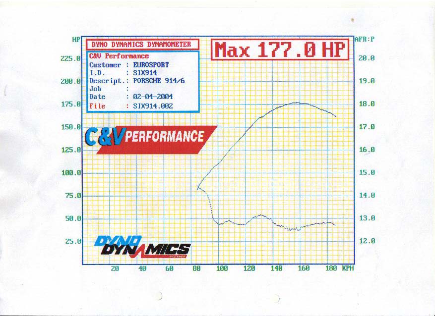

Thought you dudes might be interested in this. Gave it a run yesterday. With the conversion factor used in Porsche Cup it works out to 238hp at the flywheel.

(IMG:style_emoticons/default/smilie_pokal.gif) Nice looking curve Howard.
Can you elaborate a little on what you are running?
I'm curious as I will be running a 2.7 rs clone very shortly!

Glenn,
2.7 twin plug, 10.5 JE pistons, S cams, Webers. The twin plug part was a lot of messing around but the result is worthwhile. It pulls so well from 2-3k to 7k. Its just extremely flexible and fun.

Good job. That's mo power than I was WAGing from mine.

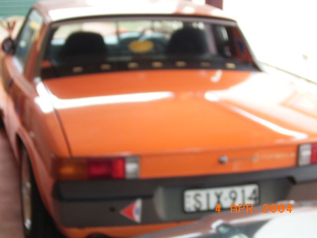

how, are you going to show us picture of your car with the sticker in the window? the only out of country car i have seen with one is beno's? you canucks too.

Drew, thats a serious amount of grunt. I assume the run was in 4th. What size tyres do you have on it?? I friend has bretty much the same spec engine in his 911 but with more comp and MFI and he's fetting around the 190 mark.
Kevin, I'll take a photo as soon as I get some light. Its 5.00 am here. I woke up early!!

Kevin,
Here's a couple of pics of the sticker.

I hear Andy take shitty pics!! did he take those pics LOL

nice dyno sheets though (IMG:style_emoticons/default/beer.gif)

I didn't realise the photos were so shitty until I saw them on the board. I will get some better ones.
On the dyno it was doing 184 kph at 7300 in 4th which is about 114 mph.
