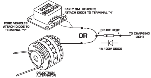

You may want to put an inline one way diode on the wire that runs to the Alt light. blue wire i think, voltage is leaking and supplying the electric ignition causing the run on.

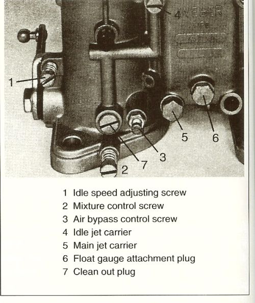

Yes, #4. Unscrew it, Don't drop the tiny rubber grommet/washer. You can take the stem out of the base, take some carb cleaner (Away from the cars), spray the base and up into the stem. It will spray outside the tip. Put the stem back on the base, push rubber grommet/washer over stem to the base. Shoot some carb cleaner into the whole in carb where the jet came out and screw the jet back in. Next one. It will go real quick.
