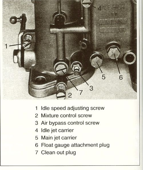

TC I assume # 4 in your diagram is the idle jets that need cleaning ? I have a new filter screen in the tank. A new filter ( metal cannister ) before the fuel pump and another metal cannister filter in the engine bay before the carbs. I thought that was enough but maybe not ? Should I add two smaller filters on the PMO fuel rails ?
carr914
Yes, #4. Unscrew it, Don't drop the tiny rubber grommet/washer. You can take the stem out of the base, take some carb cleaner (Away from the cars), spray the base and up into the stem. It will spray outside the tip. Put the stem back on the base, push rubber grommet/washer over stem to the base. Shoot some carb cleaner into the whole in carb where the jet came out and screw the jet back in. Next one. It will go real quick.
Sounds like you have enough filters, the crap that will clog an idle jet is way small. Also with the gas out there now, sometimes it's just turning to varnish quicker & clogging. Do some searching to see if you can find ethanal-free gas in your area. Our cars don't like ethanal barf.gif
