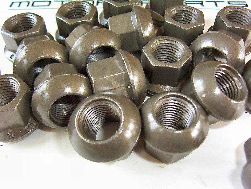

for 4 lug fuchs, i would need something like this.
http://www.928motorsports.com/parts/lugnuts.php

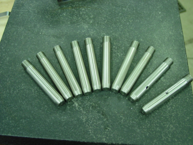

I made my own studs on my car with A/M nuts. They work great and were a fraction of the cost of stock bolts.

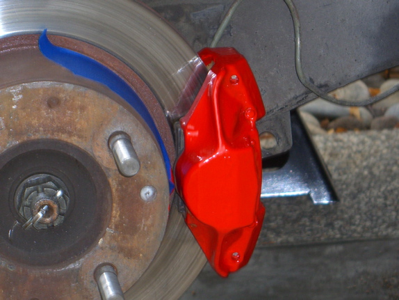

DanT
post May 8 2010, 09:44 AM
Going back to the Dark Side!
Posts: 4,300
Joined: 4-October 04
From: Auburn, CA
Member No.: 2,880

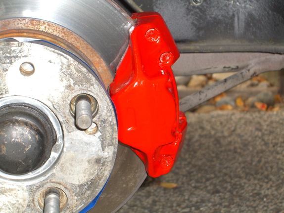

they work quite well when you choose good quality and install them correctly
these pics show BBS racing screw in studs...tough to really see since 1/2" and 3/4" spacers were still inplace over the studs...these were 80mm, so I could run large spacers and 3 different sets of wheels/tires.

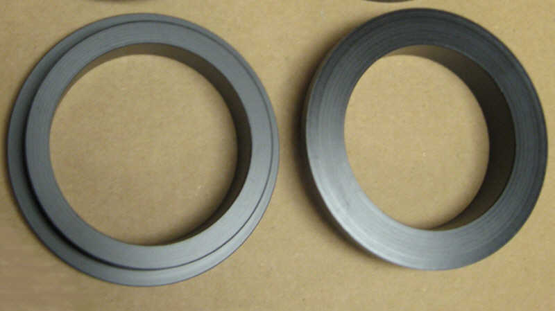

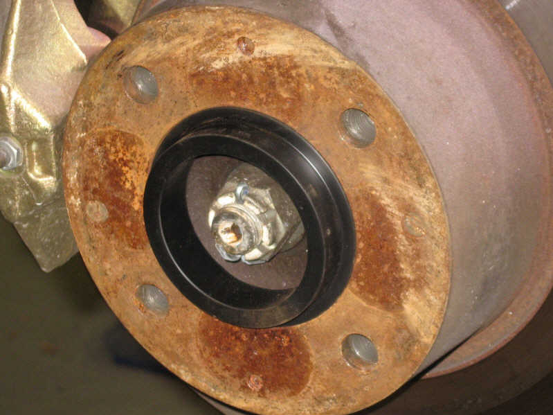

If you have hubcentric wheels here's another solution for the rear.
The wheels stay on without lug nuts.
