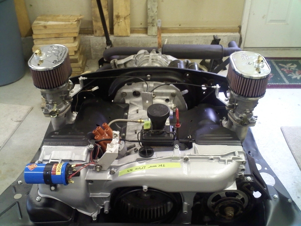

I used the same pistons and cylinders for my 2056.
I am also using ceramic lifters instead of steel (NLA, but great if you can find them).
My engine is carbed, so I have more choice in dizzys. I am using a Mallory Unilite, and a Bosch Blue coil.

My 2056 consists of Kieth Black pistons, AA cylinders, Hastings rings, Raby 9050 cam and valvetrain, 1.7 rockers with swivel adjusters, 2.0 heads, Manton pushrods, stock crank, H-beam connecting rods.

QUOTE(Cevan @ May 13 2010, 10:53 AM) *
Hey george, what type and model are you using for that nice power plant? Mike
