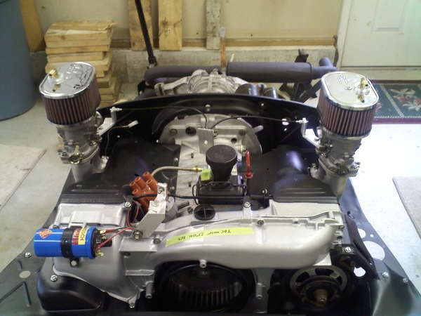

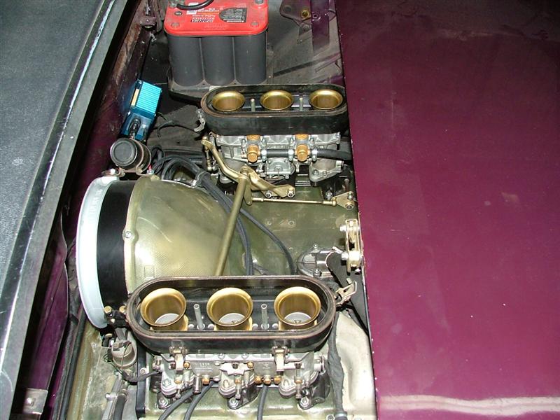

Here's my 2.7
IPB Image
More Pics of Conversion
