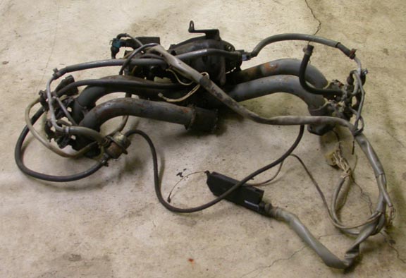

Besides the MPS and ECU, what am I missing?

a picture? a list?

Those are the only two parts you have? You're missing a whole lot.

Oops, guess it would help to post the pic. A mind is a terrible thing to miss.

Thats not a DJet system, its a '74 or '75 1.8L L-Jet. Hard to see everything at that scale.

That's a surprise. The runners were labeled as '72 914 and I took for granted it was djet. Thanks.

Wiring harness plug was the 1st thing that said not D-Jet. Fuel pressure regulator also not correct.

(IMG:style_emoticons/default/agree.gif) Plug looks like L-jet to me and it looks like the resistor pack with the bundle of white wires (4 wires to individual resistors in a silver frame).
