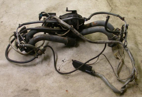

Besides the MPS and ECU, what am I missing?

Oops, guess it would help to post the pic. A mind is a terrible thing to miss.

Thats not a DJet system, its a '74 or '75 1.8L L-Jet. Hard to see everything at that scale.
KELTY360
QUOTE(Jeff Bowlsby @ May 13 2010, 10:20 PM) *
That's a surprise. The runners were labeled as '72 914 and I took for granted it was djet. Thanks.
914Sixer
Wiring harness plug was the 1st thing that said not D-Jet. Fuel pressure regulator also not correct.
type47
QUOTE(Jeff Bowlsby @ May 13 2010, 09:20 PM) *
agree.gif Plug looks like L-jet to me and it looks like the resistor pack with the bundle of white wires (4 wires to individual resistors in a silver frame).
