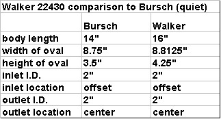

I must've gone through 30 mufflers to find one this close in dimensions. Here's how they compare:

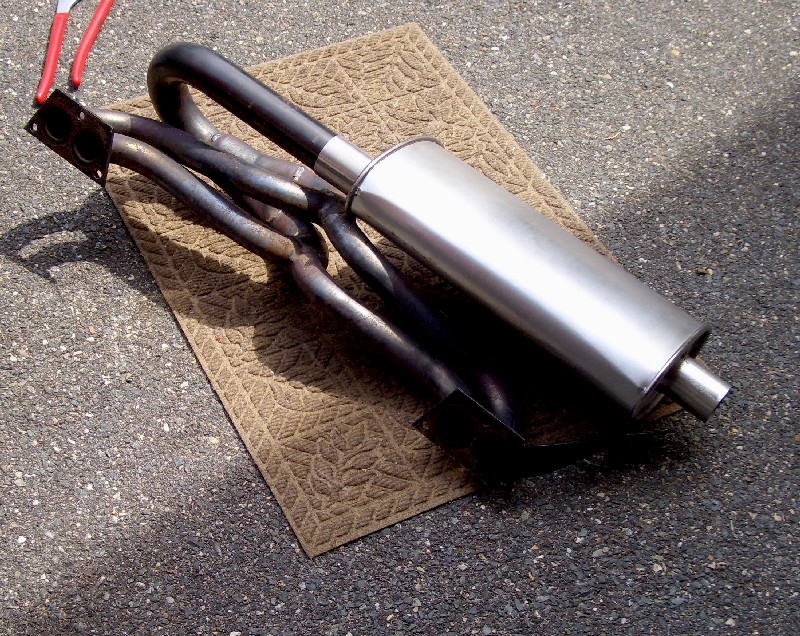

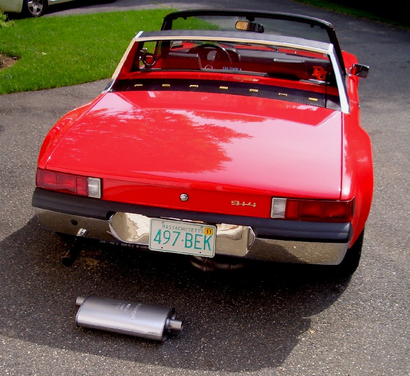

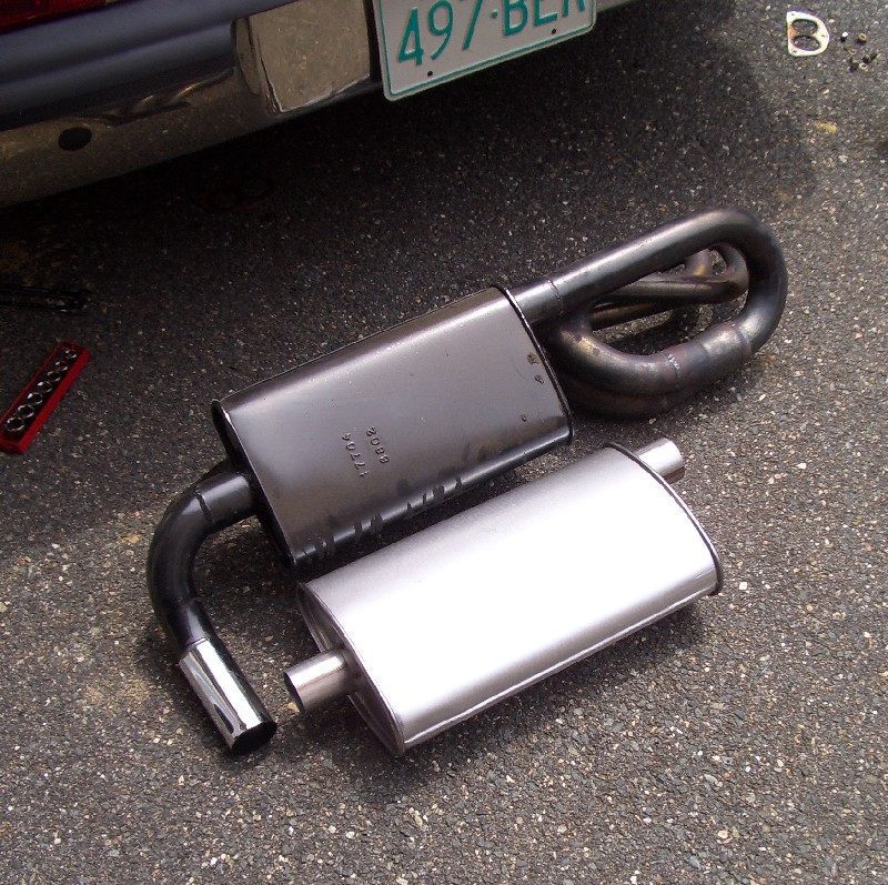

Audio below. Also, after the audio a few pics, continuing on my next post. I'll re-shoot the audio after everything's welded up.

few more pics...

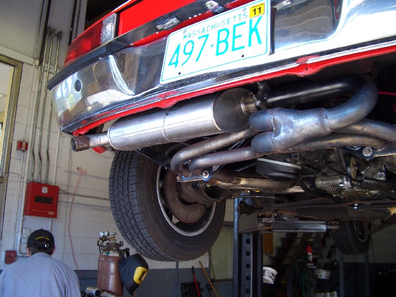

Got it tack welded. Took about 10 minutes, and he didn't even charge me! Next steps are to take the assembly back off, drill for the O2 bung, and take it in so he can finish weld it and weld the bung.
When it comes off, it'll loose the clamp that's in the picture. Also, the original Bursh chrome tailpipe attaches over the rough-looking end you see in the picture.
Noise-wise- it's like night and day! The difference may be subtle when I rev it in the driveway, but on the road, it's like night and day! This muffler is MUCH quieter and smoother than the Bursh original.
