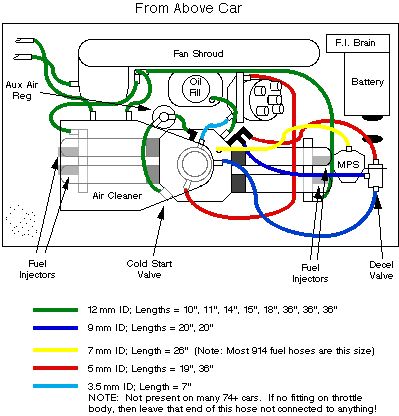

im trying to see what i have and don't have in my engine bay and why i seem to have missing vacuum hoses.
can i get a few pictures of peoples engine bays. possibly one with smog equipment and one without. and what is an anti flash back valve?

avidfanjpl   Ok. I see some things. The PCV Valve is the OEL c...   May 21 2010, 10:31 PM
mipstien   i have the aux air valve with both of its plugs in...   May 21 2010, 10:40 PM

Tom   You can look in the originality and history sectio...   May 23 2010, 11:08 AM
underthetire   If you haven't found this yet http://members....   May 23 2010, 11:19 AM

mipstien   which direction does the AAR valve go. top hose on...   May 30 2010, 05:07 PM
detoxcowboy   which direction does the AAR valve go. top hose o...   May 30 2010, 05:17 PM
mipstien   well take this for example http://www.914world.com...   May 30 2010, 05:45 PM
mipstien   ok i think i found 'stock' pictures so ill...   May 30 2010, 05:49 PM
