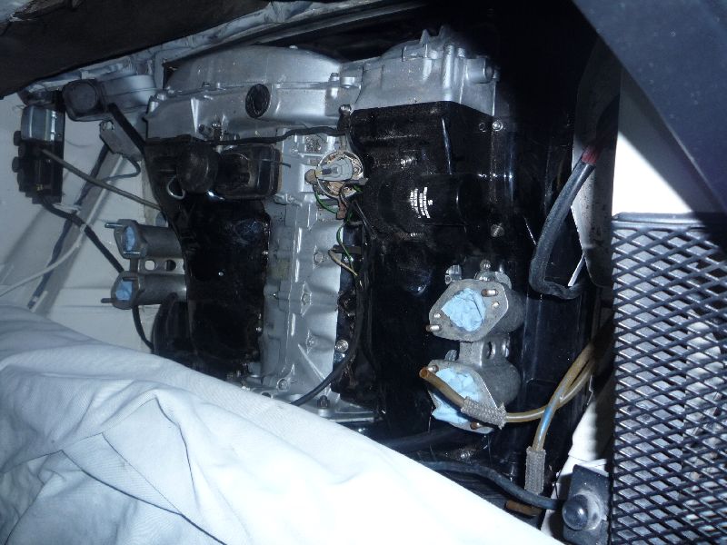

Okay so I am putting a nice set of dual weber 40's on the LE. Going to get my break in miles done & drive it while I work on the FI stuff on the side. I get the basics of how to get them on. Was hoping someone could give me a nice step by step so I don't miss anything. Or put it on in the wrong order. I got the complete setup from Rich & he included everything needed except linkage which I picked up.
I allready installed the distributor & the intakes. I know I need to get my car to TDC & make sure my firing order is right.
Okay lay it on me (IMG:style_emoticons/default/biggrin.gif) . In simple terms please (IMG:style_emoticons/default/blink.gif)

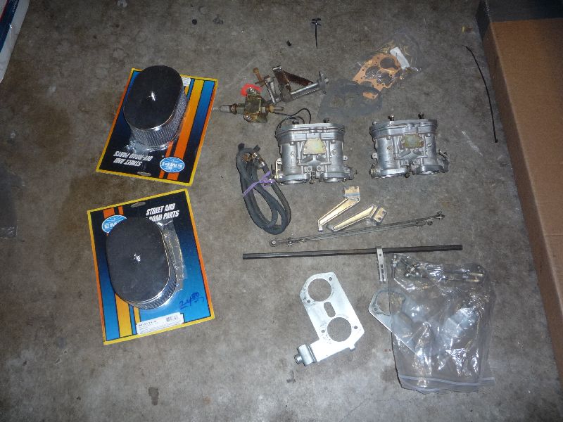

JRust
post May 25 2010, 07:33 PM
Posts: 6,317
Joined: 10-January 03
From: Albany Oregon
Member No.: 129
QUOTE(type2man @ May 25 2010, 04:49 PM) *
Bolting them on is pretty straight forward. The important part would be figuring out how much accelerator cable length you have and where it will be mounted and then you can work the linkage around it. Post up some pics of your carbs and the linkage, and I can help you out...
Here are pics
post May 25 2010, 09:47 PM
Resident German
Posts: 42,559
Joined: 21-January 03
From: Oakland, Kalifornia
Member No.: 179
QUOTE(JRust @ May 25 2010, 06:33 PM) *
Here are pics
That fuel pump is going to drive you nuts ...
(IMG:style_emoticons/default/shades.gif) Andy
JRust
post May 25 2010, 09:58 PM
Posts: 6,317
From: Albany Oregon
Member No.: 129
QUOTE(SirAndy @ May 25 2010, 08:47 PM) *
Here are pics
Tell me which one to get (IMG:style_emoticons/default/confused24.gif)
Kirmizi
post May 25 2010, 11:38 PM
Posts: 836
Joined: 12-February 06
From: Wyoming, US
Member No.: 5,568
Get a rotary, Carter IIRC, but I can't remember the part number. Probably do a forum search and find it easy enough though. I bought mine at a local FLAPS.
Waaaay quieter than that Facet pump! (IMG:style_emoticons/default/biggrin.gif)
