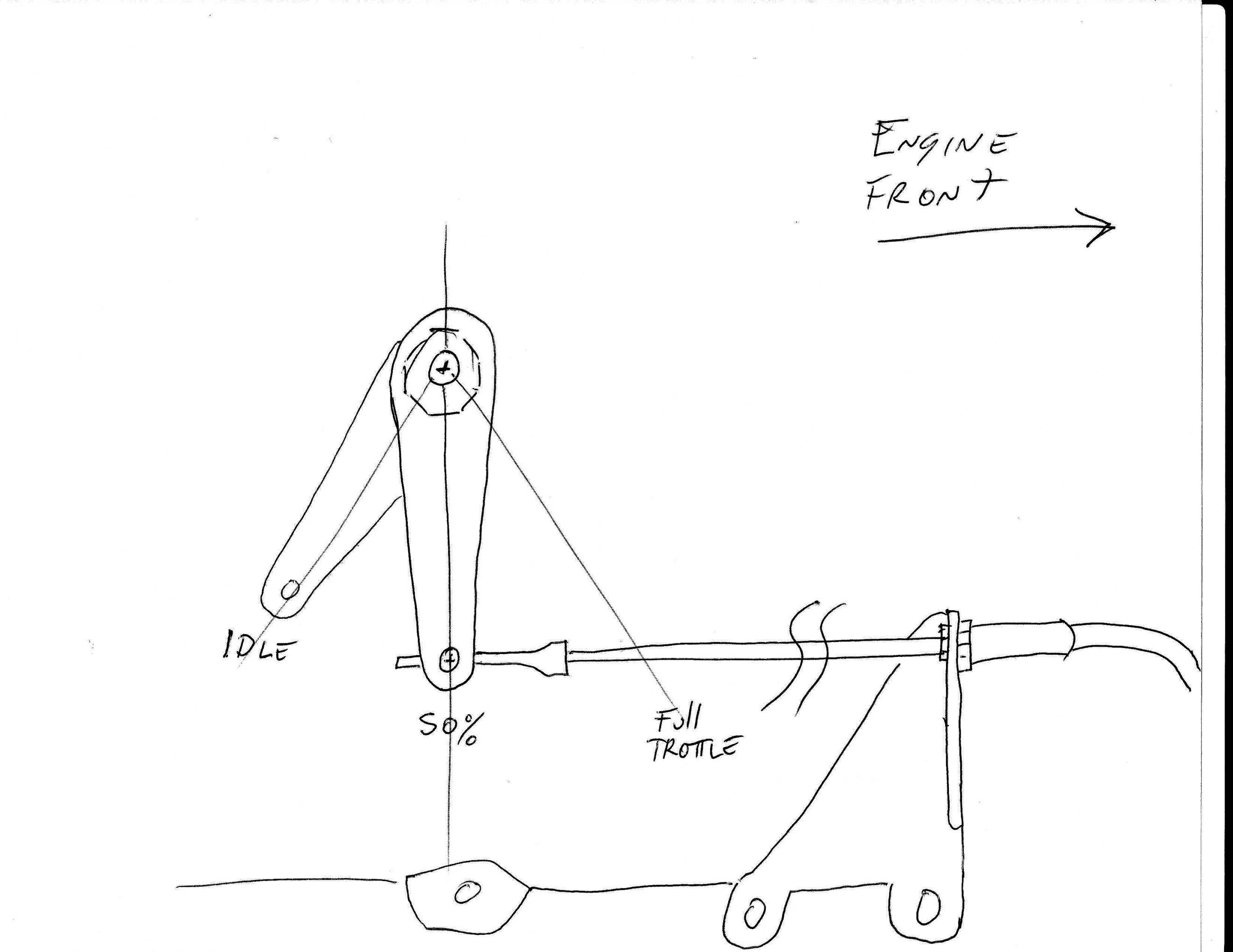

this linkage set up is also common but not my favorite. some prefer forward linkage hex bar placement for easy access. I think rear placemnet is cleanre looking

Sean, those drawings were you try to equalize everything don't always work, especially on the forward mount hex bar linkage. The reason your images/technique can be quite wrong is that on the hex bar linkage the cross-bar position is not equal on both carburetors. Your 'equalize everything' technique only works if the cross-bar arms are in the same relative position on each carb.
I prefer to simply ignore the measurements aspect, and watch both carbs to make sure they are hitting idle at the same time and hitting WOT at the same time. Then check airflow with a synchrometer at idle and at mid-throttle. When all those things are happening, the carbs are synched, even if the linkages don't measure out to be equal.

(IMG:style_emoticons/default/agree.gif) I tried to draw it out the first time, and ended up having a heck of a time getting it to work. The last time, I just did it like how Mark said, and I was balanced within 30 minutes.

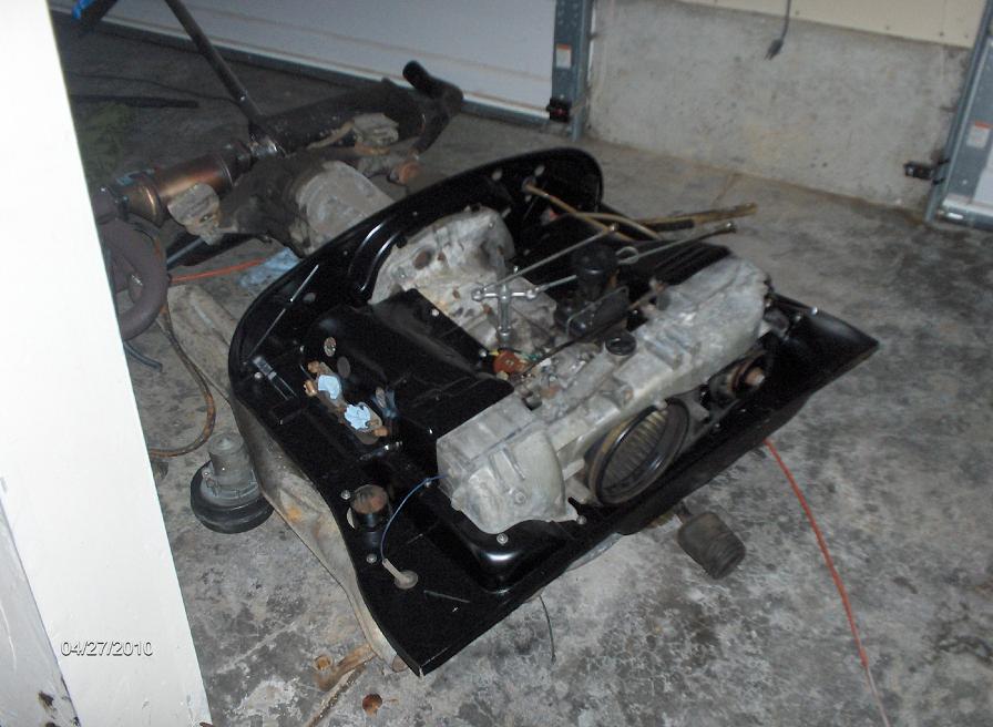

Okay thanks for all the tips! I am holding off on carbs.
I've got a guy close to work that know the FI well. I went by to talk with him & he is going to get it working for me. He is even going to take some trade. He needs a 2.0 for his LE. I will let you guys know once I am on the road with it (IMG:style_emoticons/default/smile.gif)

Thats a big NO (IMG:style_emoticons/default/stromberg.gif) for me too! It had me stumped before you guys got to try to figure it out. Of course on a trailer in a parking lot while it's dark is not the best working conditions (IMG:style_emoticons/default/huh.gif) . I did allready have all my FI off. So it needs to get put back on. I'm going to leave it to him as he may find something I missed putting them on to begin with (IMG:style_emoticons/default/dry.gif) . Either way I will just be happy to have the damn thing finished. (IMG:style_emoticons/default/blink.gif) Okay well closer to finished

Going with Carbs was always & only going to be a temporary thing. Just to get my motor broken in & get some miles on it. I was just going to get the FI figured while I was driving it.

not the measurements, just teh angles. its relative geometry L/R. I never said anything about equal measurements or length.
your probably right. I guess the proof is in the results.
some people can learn a proceedure and some learn and understand teh relationships that make a system work

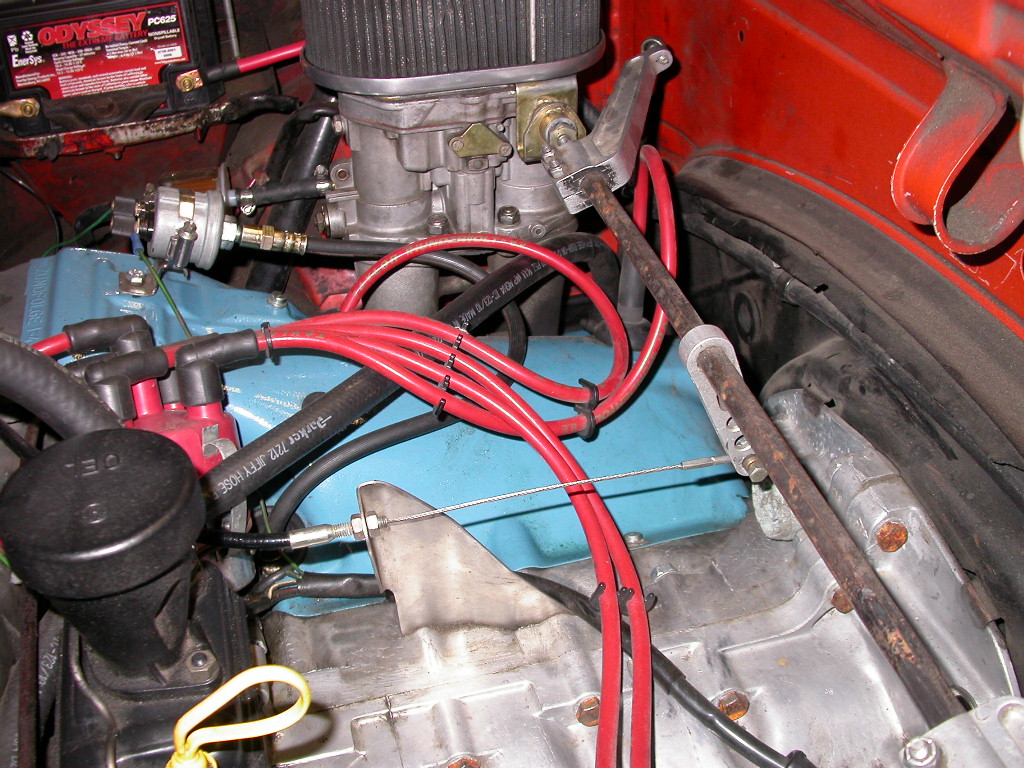

These are good linkage pictures, what kind of linkage is this?

More of it, it's on my engine, haven't seen it used on anything before.
It works really nice, easy to adjust, can't find it new anywhere though.
