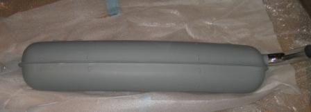

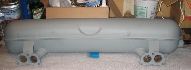

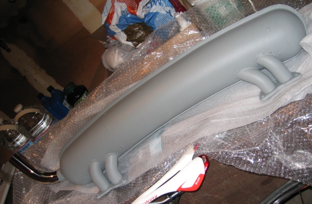

How about these?

perfect, thanks (IMG:style_emoticons/default/biggrin.gif)

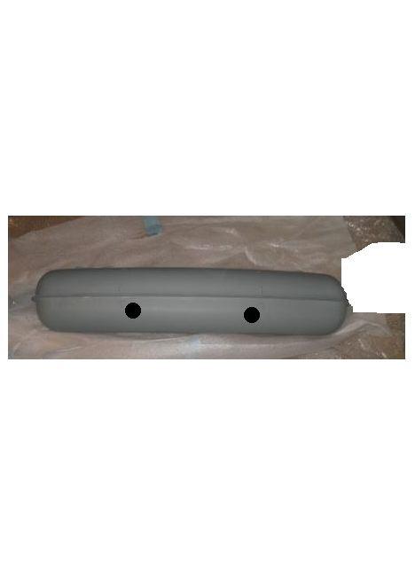

thinking about this... (IMG:style_emoticons/default/biggrin.gif)
twin piped in this general layout...SS pipes of about 8-10" in length..

Contact jgara962. He just pulled one of those off his car and won't be reusing it.
That'll sound really nice on your new 2270. (IMG:style_emoticons/default/happy11.gif)

In the pictures, what'd you use to treat / prep it? and coat it? This is on my list...

Rob, the pic I am using is not my muffler.
I plan on doing a complete media blast if I find what I am looking for and then I will decide on what high temp paint I will use...SS twin pipes.
I may have a line on one that is already done... (IMG:style_emoticons/default/biggrin.gif)

High temp BBQ paint has done well for me. If you have a new muffler, remove all the primer down to bare metal. If you have an old muffler, wire wheel all the rust scale, then treat with Metal Ready, then paint. Mufflers are more likely to die from the inside out, so the outer coating isn't the common point of failure as long as quality products and prep are used.
