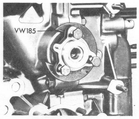

Thanks for the seal advice, but I am contronted with the hub itself and how do you pull that off, I have taken the nut off and am ready to pull it but do not want to destroy anything by ignorant force.. ..

Mc mark, I just may take you up on that, but the hub removal is the main issue and that tool looks like a c shaped plate according to the fsm, as far as the seal I have the seal puller but not the installer. I have 2 new seals, so If I bugger one up, I will pm you..

The hub has a #2 morse taper on it that affixes it to the crankshaft, they can be difficult to remove.. a steering wheel puller is generally the most general tool used for this.
Once the hub is pulled the seal easily is removed, you can use a drywall screw inserted in to the seal to pull it from the case. Note that there is an O ring between the hub and the crank- replace it.

For you dyi guys.. go to Harbor freight and get a "bolt grip puller" set. It can be used to pull the hub.
Also, when you put it back, take a brass hammer (also available at harbor freight) and give it a good whack before installing the bolt in the crank center. And use a torque wrench to tighten the bolt.

2 sturdy old fashioned "church keys" substitute well for the factory tool. The thicker the better, and it's best to use the hardest ones you can find. Be sure to use bolts other than the 3 you want to use for reinstalling the fan. The ends are apt to get chingered up. As others have pointed out, be sure to replace the o-ring as well as the seal. It'll leak if you don't.

That solved it Cap'n even after I took a steering wheel puller on loan, could not get the puller to line up any whihc way, I used 3 large thick construction washers, popped of w/ an instant ..
