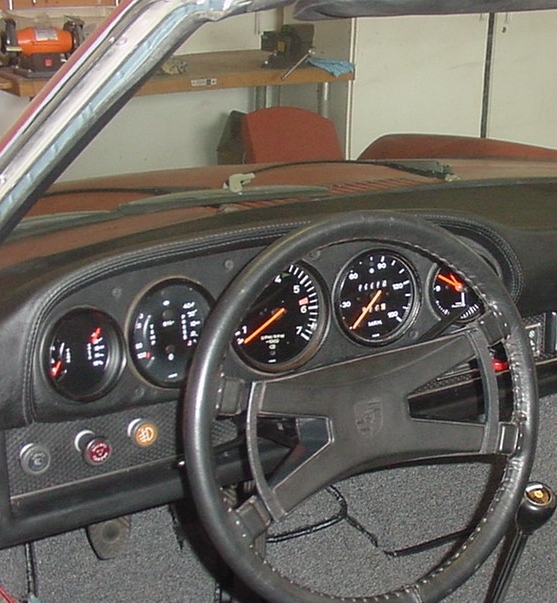

On a side note, do you still happen to have the stock steering wheel that came on the red car I sold you? It was originally on my v875 and put it on the red car because the car needed a wheel. I would be interested in purchasing it if you have other plans. I might pull my momo off.
