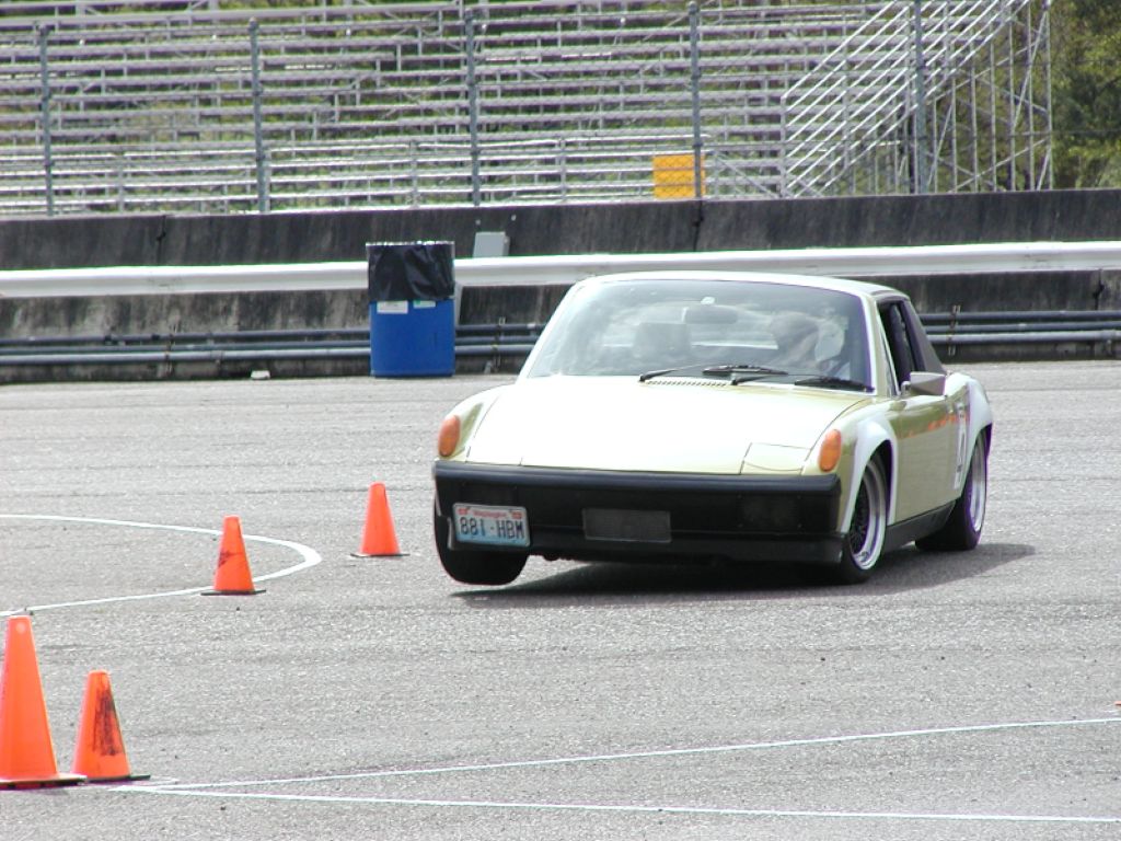

Almost forgot here are some pics. I still have to install the rockers and valances but you get the idea. Her nickname is yellow jacket (IMG:style_emoticons/default/biggrin.gif) .

QUOTE(rfuerst911sc @ May 31 2010, 10:17 AM) *
Bitchin! (IMG:style_emoticons/default/thumb3d.gif) If I ever make it to Florida you'll have to take me for a ride. Good luck and keep us posted.
