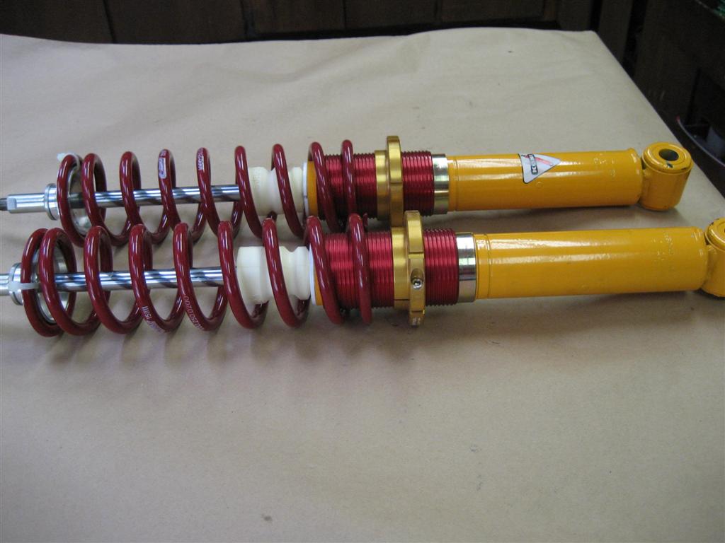

Yes they are Koni reds with 140 lb. springs. And yes the ass of the car is a little higher than I like that's why I was wondering about the adjustable spring perches. I am familiar with Paragon and have looked at their kit. Seems like a good value. I have a 19mm H&H adjustable sway bar up front. It has 3 adjustment holes and I currently have it set to the middle hole. My mechanic did the corner balance and I forgot to get any data other than she was 2100 lbs. but I can always ask him. Thanks for the feedback beerchug.gif .

Almost forgot here are some pics. I still have to install the rockers and valances but you get the idea. Her nickname is yellow jacket biggrin.gif .

Bitchin! thumb3d.gif If I ever make it to Florida you'll have to take me for a ride. Good luck and keep us posted.
