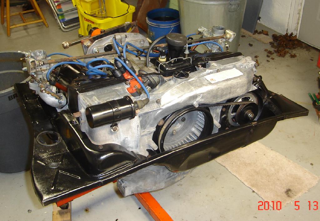

hijack:
what carbs are those? a 2l+ should have at least 40s, those look like solexes...

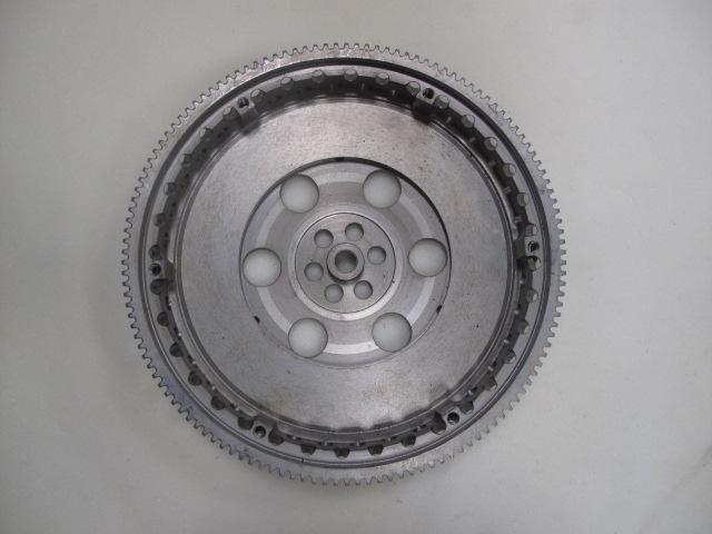

This is the Flywheel I like to use on my 6 cylinder cars - a 906 Unit that weighs in @ 7 lbs.
Like others, I was advised not to do it - Hogwash. Does it spin up & down Faster - Yes, Does it take some getting used to - Yes. But I like it.

ScottD914
post Jun 2 2010, 05:56 PM
Posts: 69
Joined: 27-December 07
From: New London, CT
Member No.: 8,506
Yes, I suspected the carbs are under sized. They are Weber 34 ICT's I
bought before any research. Never ran them. Now I'm looking for a pair
of 40's.
