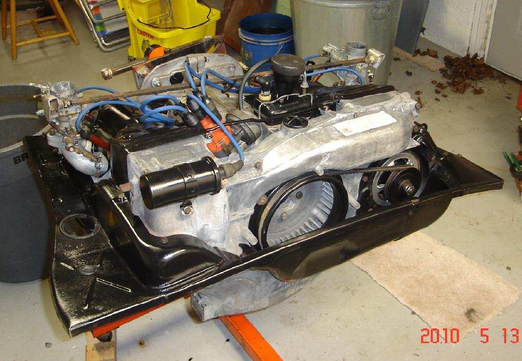

Thanks Gentlemen for all the great input. I'll go with the
lightened FW for now and see how it works. One nice thing is that it would
not be a major job to switch to a std. weight if it doesn't work out.
Click to view attachment Thanks too to Jake and all that helped with other info to walk me through
the rebuild process. ScottD

what carbs are those? a 2l+ should have at least 40s, those look like solexes...

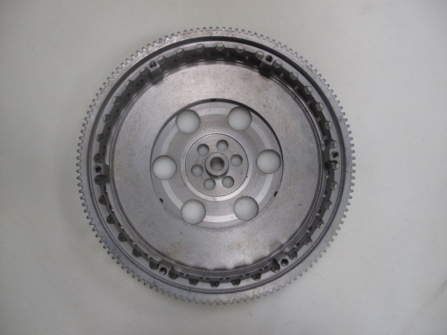

This is the Flywheel I like to use on my 6 cylinder cars - a 906 Unit that weighs in @ 7 lbs.
Like others, I was advised not to do it - Hogwash. Does it spin up & down Faster - Yes, Does it take some getting used to - Yes. But I like it.

Yes, I suspected the carbs are under sized. They are Weber 34 ICT's I
bought before any research. Never ran them. Now I'm looking for a pair
of 40's.
