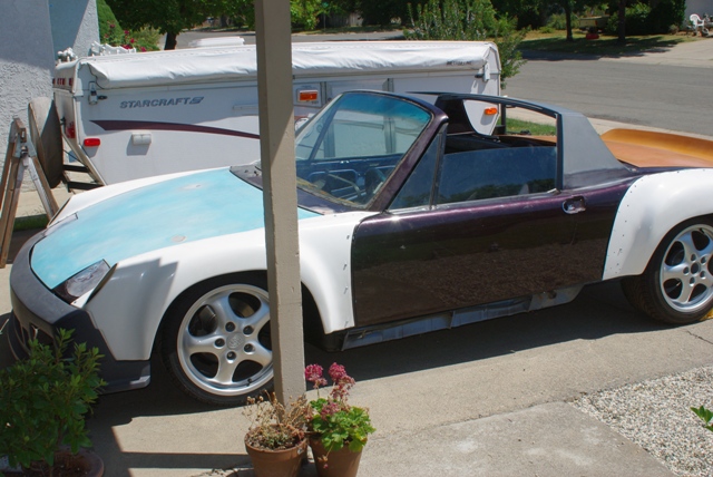

I bought this as a stripped down rolling chassis. The sller put wheels on it to get it on the trailer. That was 4 long years ago. I also had a son at the same time so working on the car has been a second priority. Now the engine is in and the brakes are on, I should be able to get some work done more quickly. I plan on firing this up within the next couple of weeks and taking on a drve by the end of July. I got the 3m adhesive today to get the fenders bonded on and then the fun stuff begins. Hope to get it completed in time for next years West Coast Ramble. Thanks to the support and motivation of the 914World. (IMG:style_emoticons/default/biggrin.gif)

(IMG:style_emoticons/default/beer.gif) (IMG:style_emoticons/default/beer.gif) Keep on making progress (IMG:style_emoticons/default/smilie_pokal.gif) (IMG:style_emoticons/default/smilie_pokal.gif)

WooHoo! (IMG:style_emoticons/default/beerchug.gif)

I forgot to add the picture (IMG:style_emoticons/default/wacko.gif)

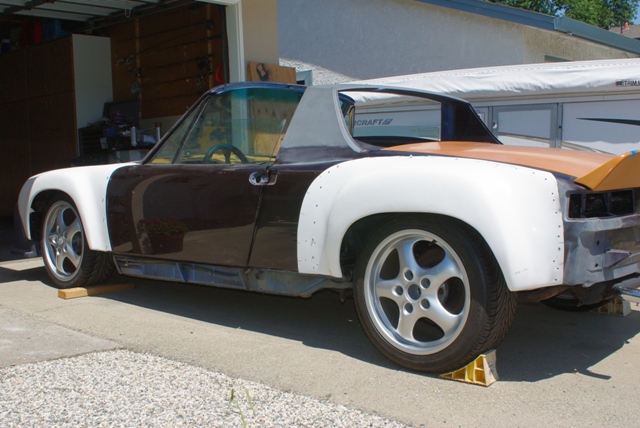

Another view. I love the look of the 17" wheels.

Just for the record, 17" wheels do fit with the AA wheel adapters. They are 17x7.5 up front and 17x9 in the rear with 205/40 and 225/45 tires. There is only about 7mm of clearance on the inside of both. First drive will tell for sure if they work.

Yes I will be taking pictures of the flares as they go on. I will be using the 3M 8115 panel bond adhesive and filling the gaps with body filler with the fiberglass strand in it. Then I will put on a smooth coat of regular filler to finish. I havent done any body work since 79 so this should be fun.
