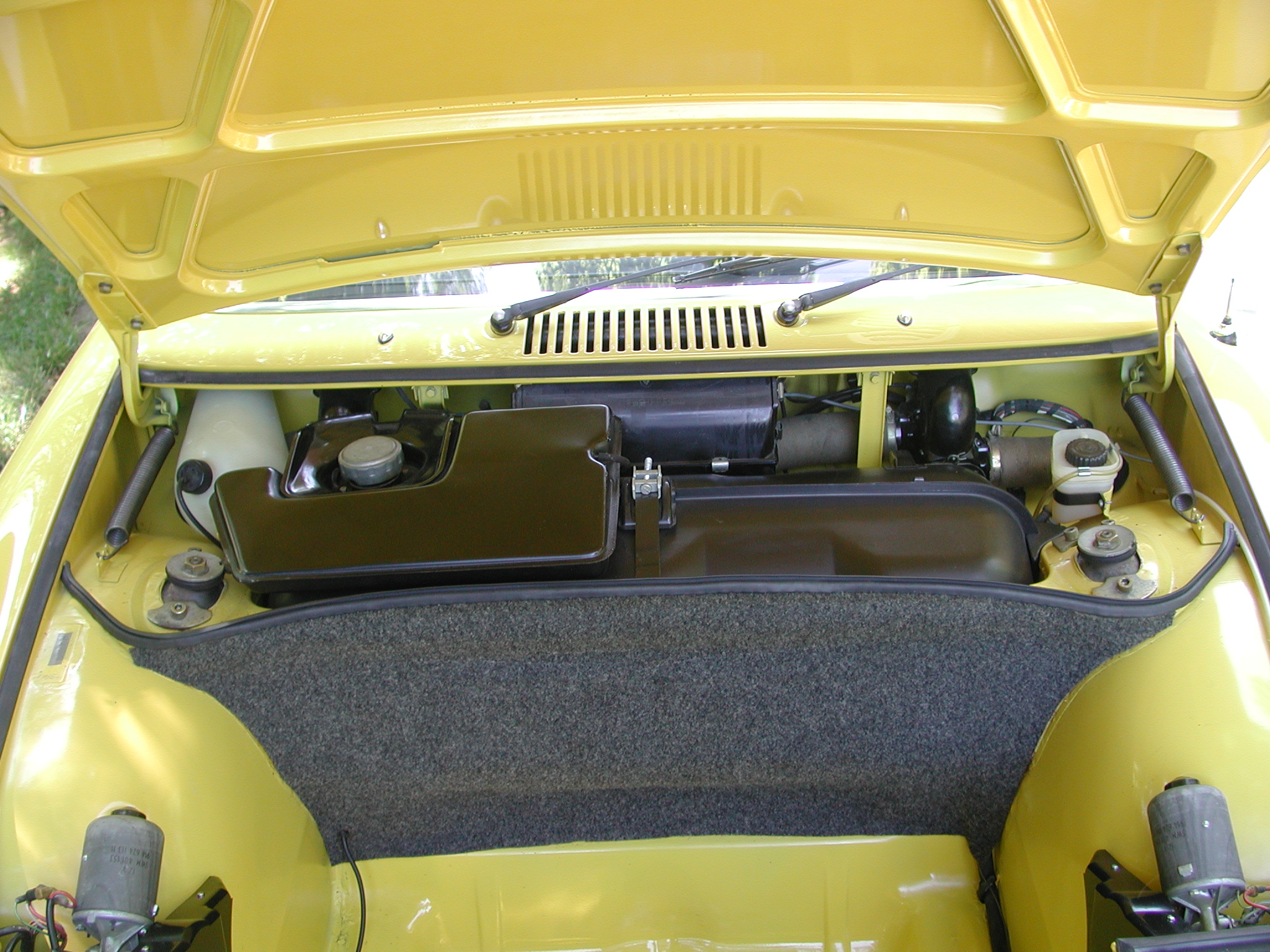

Not all 914s had a charcoal canister. This, from an early '70/4......
1970 Neun vierzehn
post Aug 28 2011, 06:00 PM
Post #23
Posts: 3,199
Joined: 16-March 06
From: cincinnati, ohio
Member No.: 5,727
the '70/4 is a 49 state car, built date 01/1970
