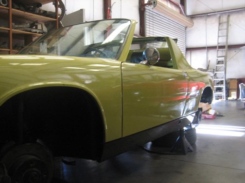

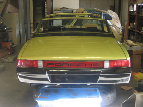

didn't get everything done as i had hoped (typical for me). got the dash and the rear bumper on however. had to fabricate a couple brackets (one twice) and still might make a few adjustments to the fit, but it's close. is there a company that makes brackets specifically for fiberglass bumpers? probably depends on the mfg...
NSR-JAMIE >> as far as the GT door panels, i bought them off ebay. they are good quality, but the release strap didn't work with the clip they supplied. had to use a small nut and bolt to attach it to the release mechanism.

so it has been a while since i've updated the photos... here we go. trim, bumper/rocker panels, wiring, dash, paint, and brakes are done. car starts and sounds pretty mean. can't wait to get it on the pavement!

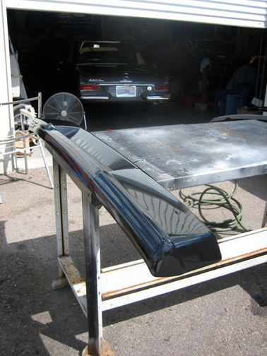

painted the top rockers, and bumpers, but not sure the satin finish they said it would have is right. might have to repaint, but leaving these shiny for now.

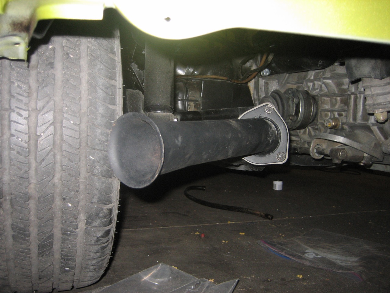

now to the mounting of the trunk... using pins since the hinge mounts are non existant. eventually will go with a fiberglass lid too.
