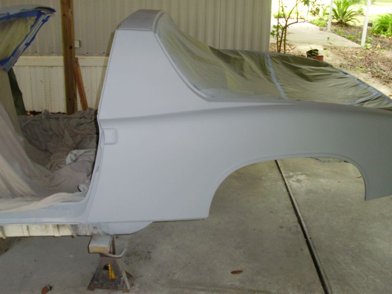

Thanks guys. The wind was low, but the temp was high. I had already checked with the paint store and they said I could add a little bit of lacquer thinner to the slow the drying down, which I did. Yes, I plan to sand the guide coat...
Bugs in FL? ... (IMG:style_emoticons/default/blink.gif) Those aren't bugs, they're the state bird.... (IMG:style_emoticons/default/biggrin.gif)
Here's a pic after prep and primer...
-- Rob
