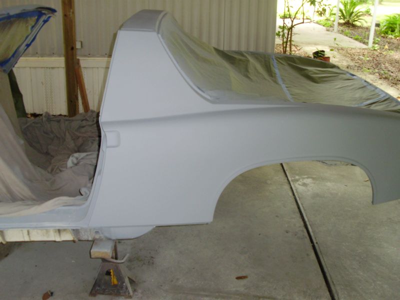

Thanks guys. The wind was low, but the temp was high. I had already checked with the paint store and they said I could add a little bit of lacquer thinner to the slow the drying down, which I did. Yes, I plan to sand the guide coat...
Bugs in FL? ... blink.gif Those aren't bugs, they're the state bird.... biggrin.gif
Here's a pic after prep and primer...
