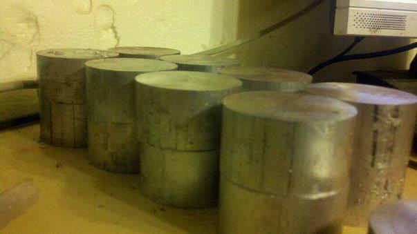

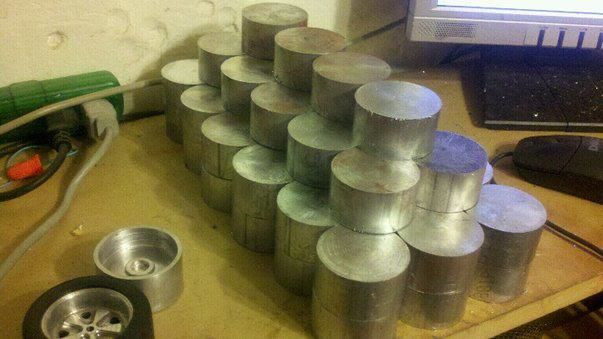

Drew, yes. (IMG:style_emoticons/default/smile.gif) Some have even paid to help cover R&D on the project. (and; Jamie from Japan, and Jeff From CA, have sent tooling and offered up suggestions/advice to help with the learning curve)
The pictures below:
the larger stack are all sliced and squared and ready to be cutdown to size.
to make them look like the other stack. They are all squared up from where the band saw cut crooked. (put them on the lathe for this) after the lathe, they went to the mill because it is set up to run from the computer and it cuts them to size more quickly than I could do by hand on the lathe.

If you have any access to a surface grinder would be a good time to very gently surface grind them to a perfect flat finish on both sides. It makes a better product and setting up in the CNC is a bit easier and they come out much nicer.
Or like another member mentioned....it might be better to make some kind of mold and just pour the molten alloy into it...can you say "INVESTMENT CASTING" ...this is actually an old technique they use to make jewellery with a "lost wax" or wax melting process...not too expensive and easy to machine but you would need a foundry friend who seems to be offering his services. (IMG:style_emoticons/default/biggrin.gif)

Jamie, thank you for the tip. (IMG:style_emoticons/default/smile.gif)
I'll probably be getting ahold of rohar on the phone sometime within the next month. He seems to be busy with a move at the moment, and I still need to make a perfect finished product.
It's getting closer each day, and I'm pretty excited about it.

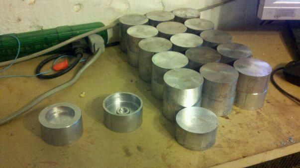

update pic:
I am really making some good progress now. (IMG:style_emoticons/default/smile.gif)
I did some more. I have a stack of about 50 wheels in the making.

Yes sir.
I kept going!
This is the last of the narrow ones being made into blanks.
