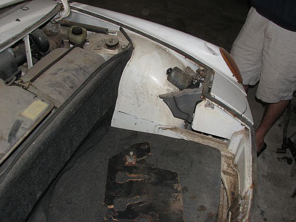

Here is 15650 with chassis number from the 3rd week of March for example:

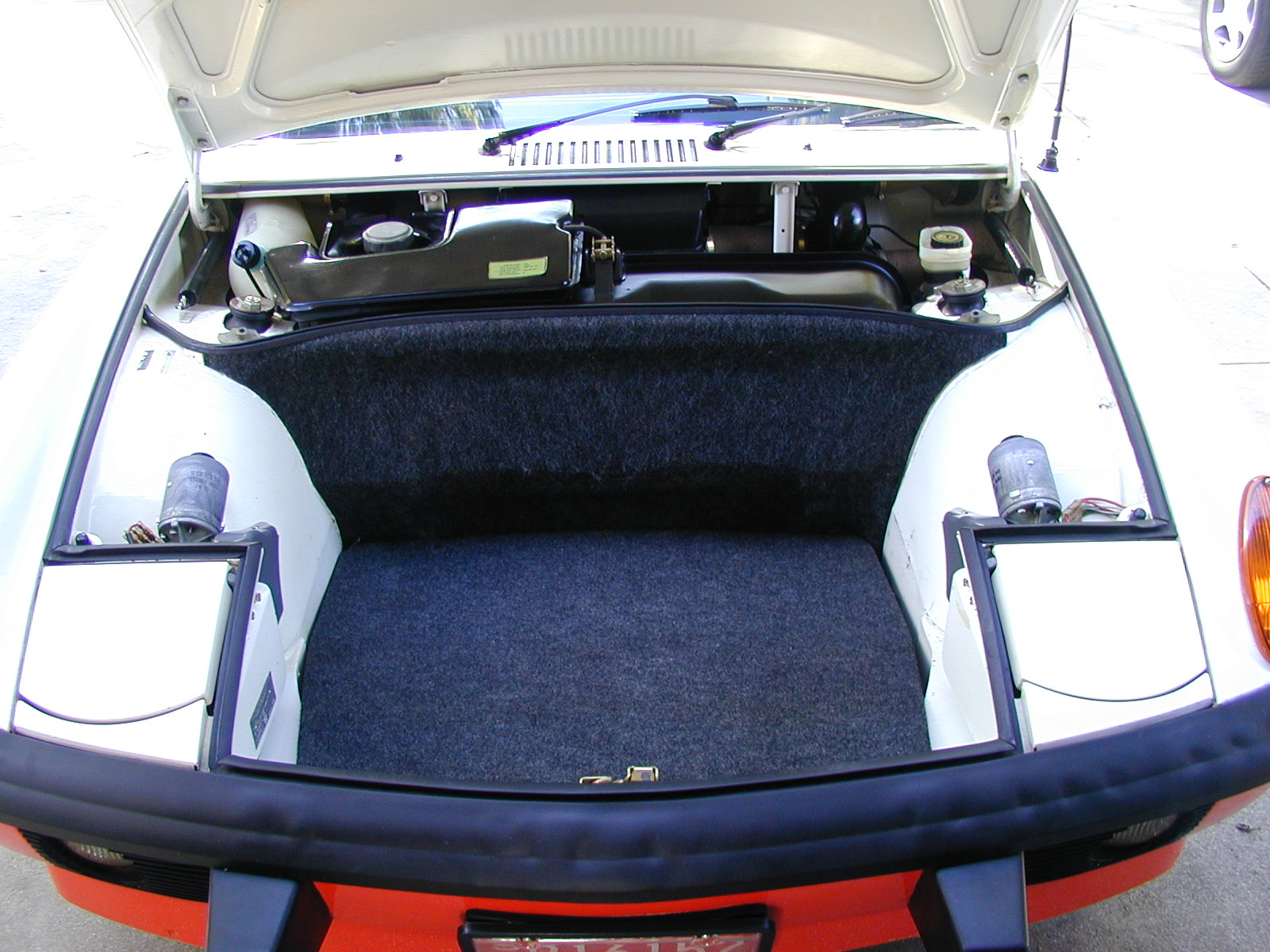

But there is more from the secret LE files. First photo below is 16695 with a chassis date of April 5. Second photo is VIN 16760, thats the latest LEs I have tank photos of. All are early tanks.
