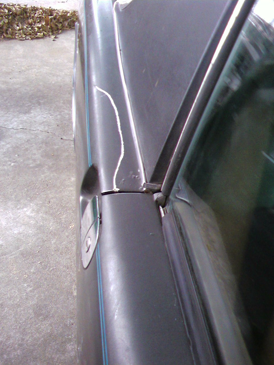

Tinted glass at the windshield &/or sides (roll-up & triangle windows) was an option at all years, but never tinted the rear wdo. (it was shaded by the rollbar/sails anyway).
My early-73 2L (8/72 build date) has "tinted glass all around" (sides & windshield - not rear) on the COA under options, & Has had them since I bought it used in 12/75 (3 yrs. old).
It is a green tinted safety glass, as you can see in this pic of pass wdo.

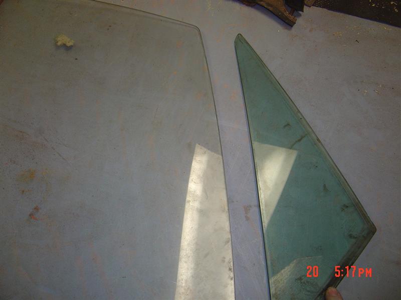

2 versions next to each other. The tinted was the " Spain or Spanish option " IIRC

QUOTE(scotty b @ Apr 10 2011, 11:17 AM) *
I don't know about the Spain or Spanish reference but I agree that tinted glass was an option throughout production.
I have it on my '70 and my '75 and neither was ever in Spain
The tint is a bit subtle. To be sure check the markings. Plain is Dolour 1, Tinted is
Delour F
