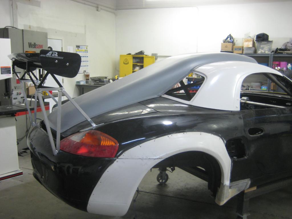

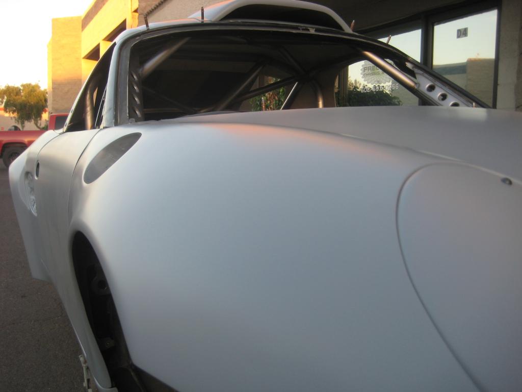

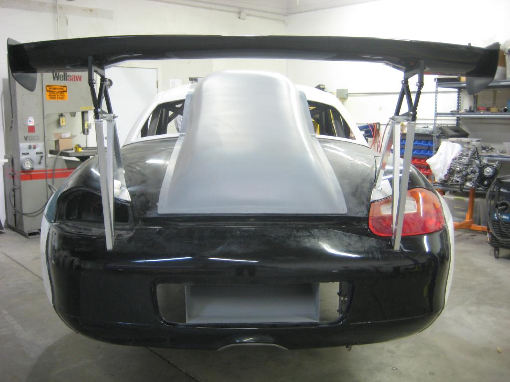

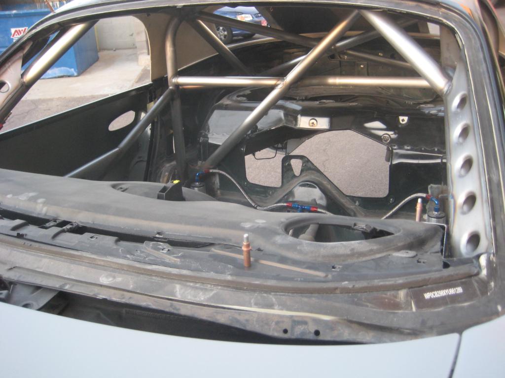

Added a rear wing...
(IMG:http://www.914world.com/bbs2/uploads_offsite/i180.photobucket.com-11979-1294881484.1.jpg)
(IMG:http://www.914world.com/bbs2/uploads_offsite/i180.photobucket.com-11979-1294881484.2.jpg)
(IMG:http://www.914world.com/bbs2/uploads_offsite/i180.photobucket.com-11979-1294881484.3.jpg)

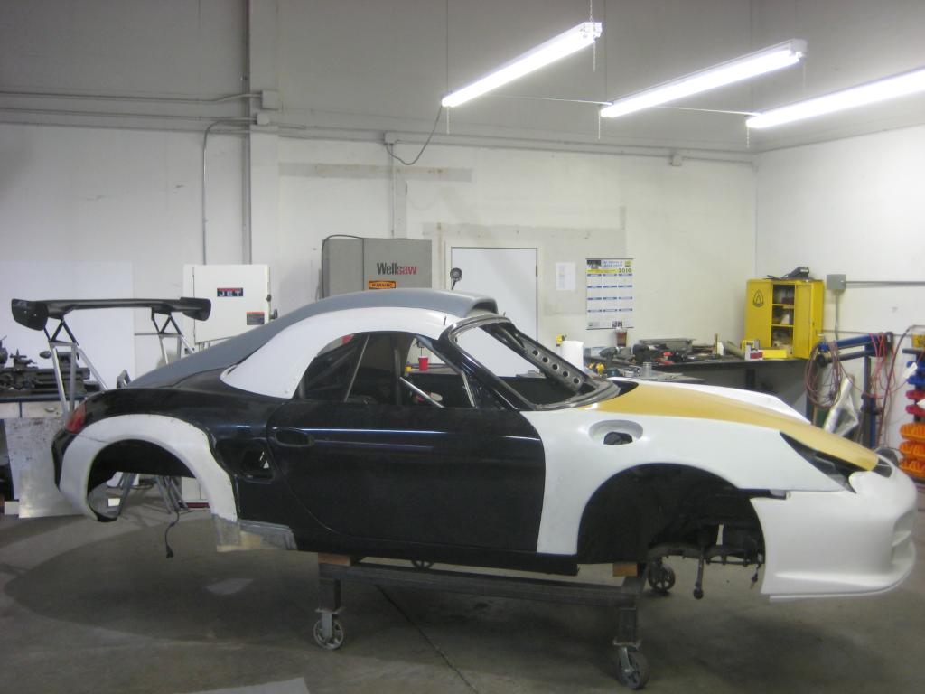

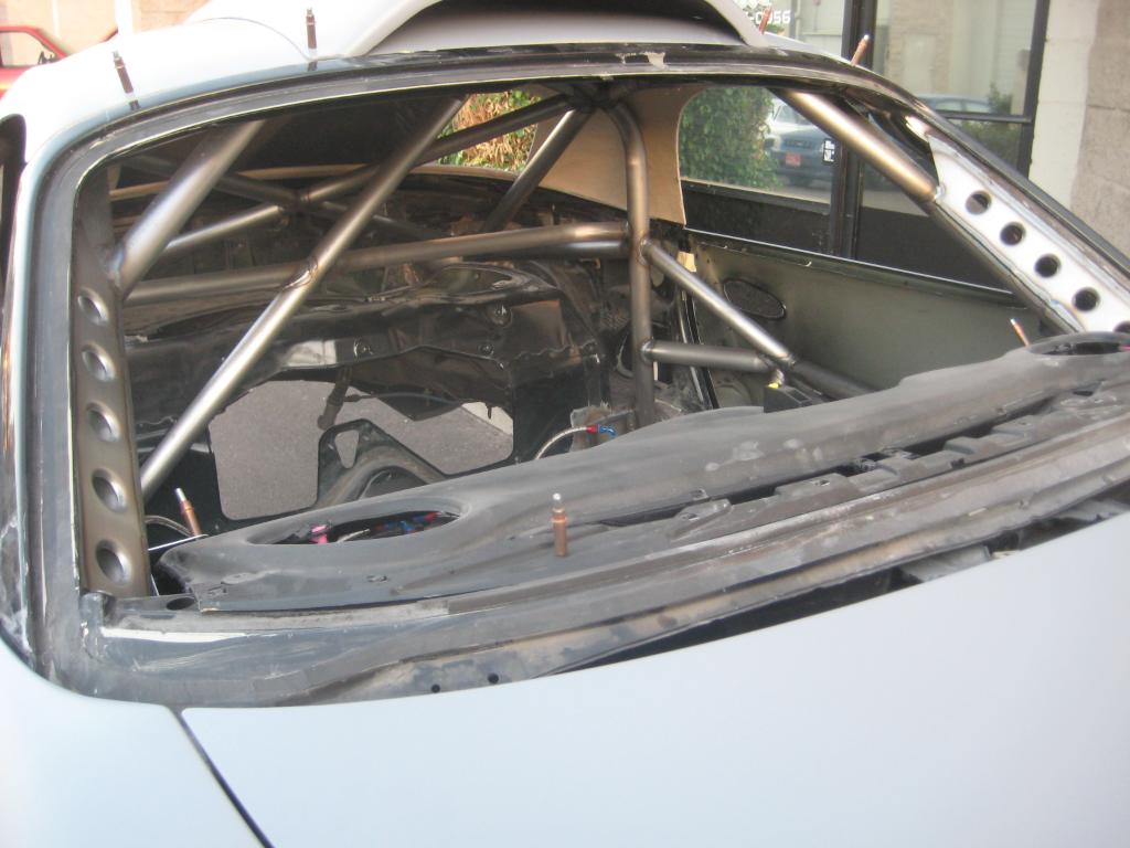

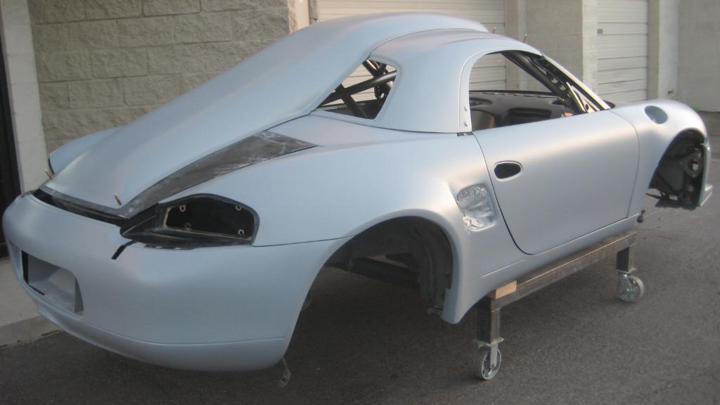

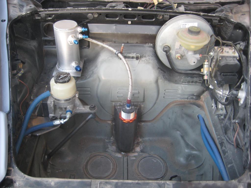

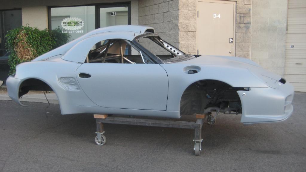

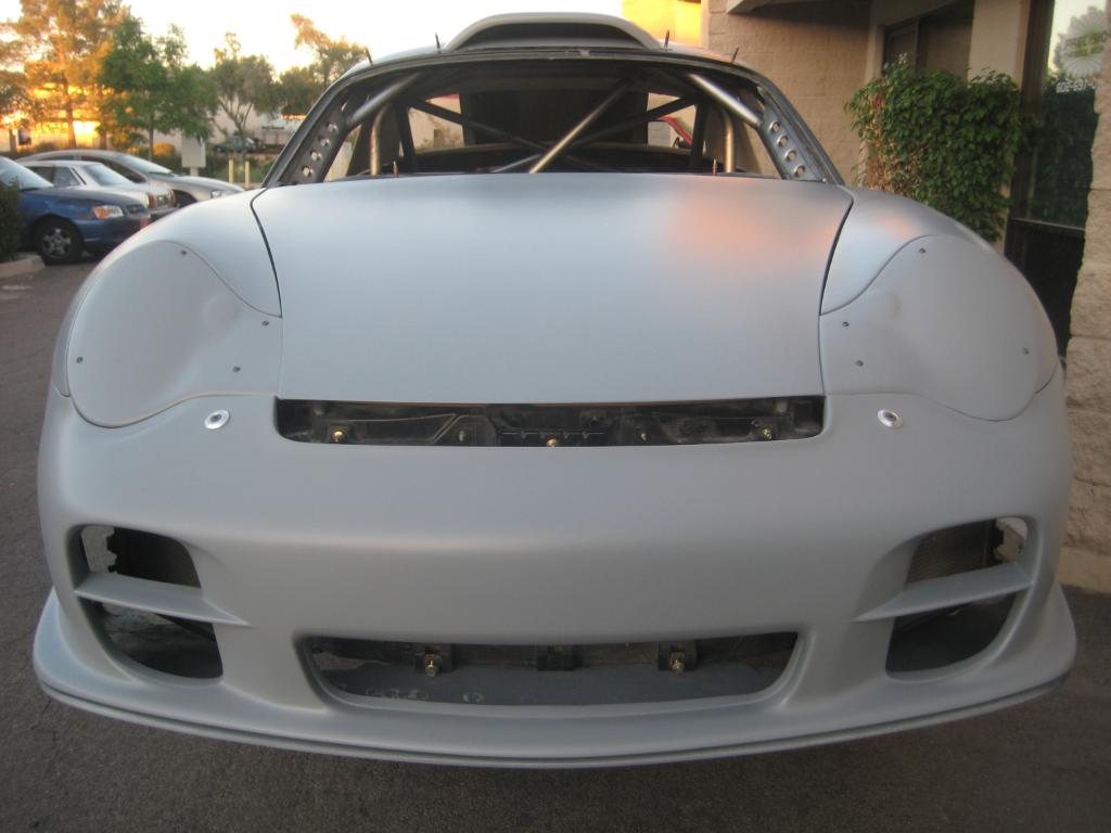

Quick update with everything in primer. Just waiting on the wheels to be made so I can test-fit everything before I final sand and start painting everything.
(IMG:http://www.914world.com/bbs2/uploads_offsite/i180.photobucket.com-11979-1305501177.1.jpg)
(IMG:http://www.914world.com/bbs2/uploads_offsite/i180.photobucket.com-11979-1305501178.2.jpg)
(IMG:http://www.914world.com/bbs2/uploads_offsite/i180.photobucket.com-11979-1305501178.3.jpg)
(IMG:http://www.914world.com/bbs2/uploads_offsite/i180.photobucket.com-11979-1305501178.4.jpg)
(IMG:http://www.914world.com/bbs2/uploads_offsite/i180.photobucket.com-11979-1305501178.5.jpg)
(IMG:http://www.914world.com/bbs2/uploads_offsite/i180.photobucket.com-11979-1305501178.6.jpg)
(IMG:http://www.914world.com/bbs2/uploads_offsite/i180.photobucket.com-11979-1305501178.7.jpg)
(IMG:http://www.914world.com/bbs2/uploads_offsite/i180.photobucket.com-11979-1305501178.8.jpg)
(IMG:http://www.914world.com/bbs2/uploads_offsite/i180.photobucket.com-11979-1305501178.9.jpg)

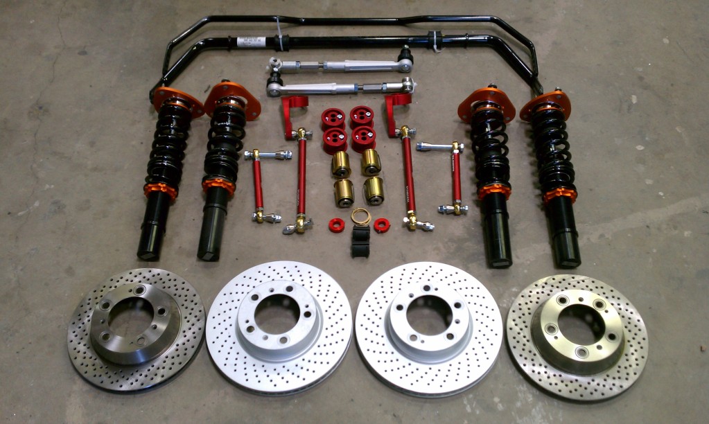

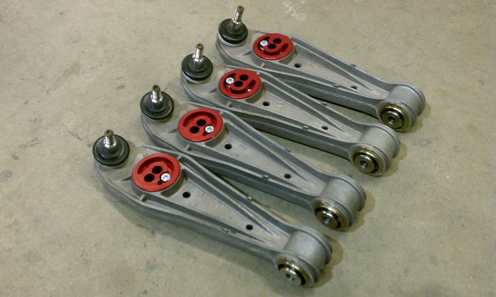

Some suspension bits...
(IMG:http://www.914world.com/bbs2/uploads_offsite/i180.photobucket.com-11979-1307694239.1.jpg)
Control arms with some of those pieces installed. There won't be a single rubber bushing anywhere on the car. Everything is mono-ball or solid.
(IMG:http://www.914world.com/bbs2/uploads_offsite/i180.photobucket.com-11979-1307694239.2.jpg)

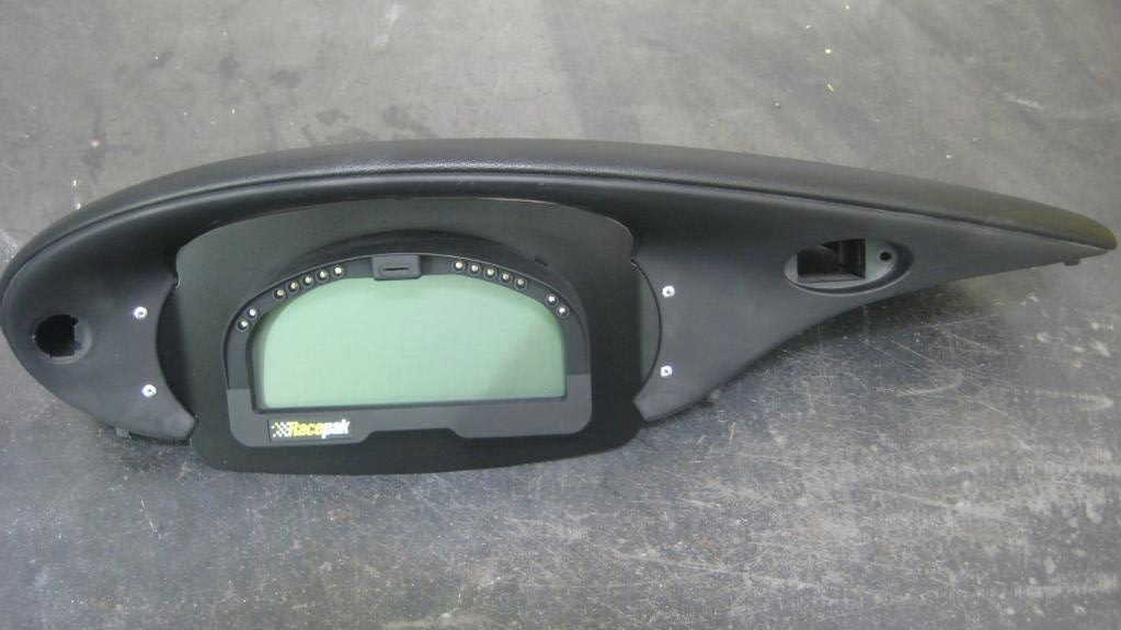

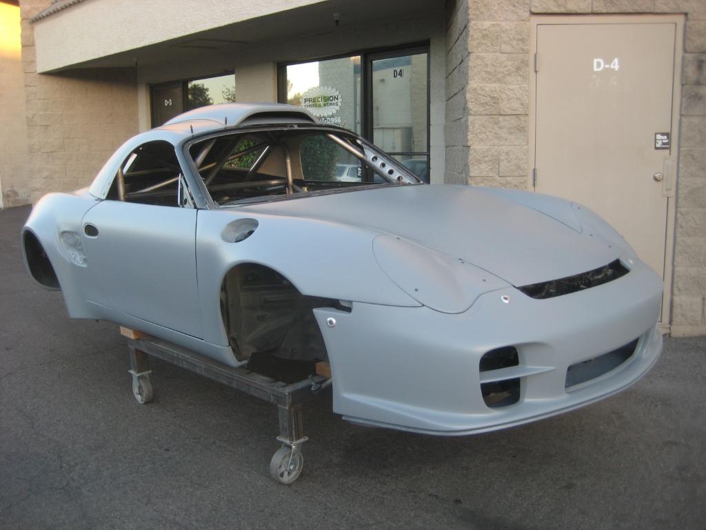

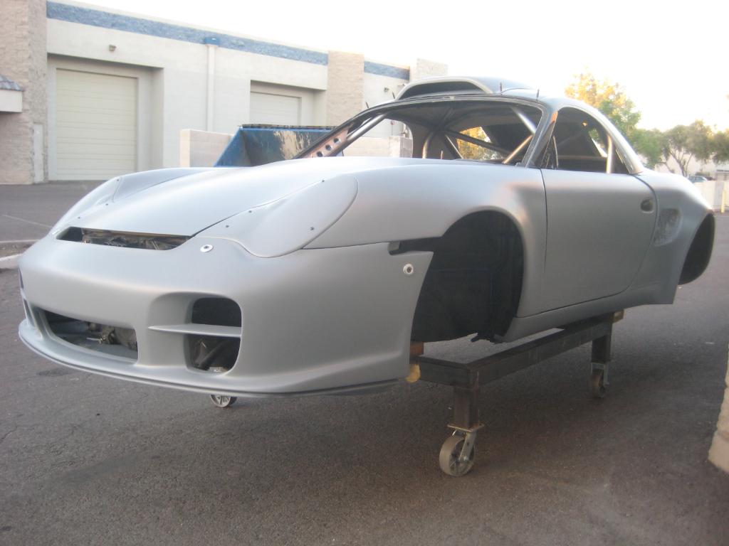

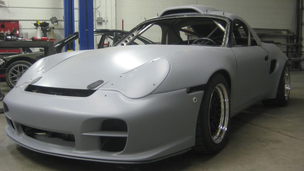

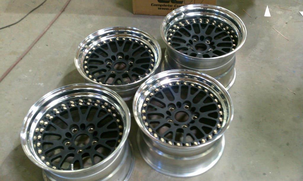

Been making some good progress lately. The wheels came in so I was able to mount some NT01's on them and make the car a roller (temporarily) to verify tire/wheel fitment with the quarter panels and suspension. I need to add some 8mm spacers on the rear so I can lower the back end of the car to a more appropriate ride height, but otherwise everything fits great so the next step is to start painting stuff.
Here is a teaser pic of the car on the ground for the first time in almost a year, and the Racepak dash that I mounted in place of the stock gauge pod.
(IMG:http://www.914world.com/bbs2/uploads_offsite/i180.photobucket.com-11979-1307694240.3.jpg)
(IMG:http://www.914world.com/bbs2/uploads_offsite/i180.photobucket.com-11979-1307694240.4.jpg)
(IMG:http://www.914world.com/bbs2/uploads_offsite/i180.photobucket.com-11979-1307694240.5.jpg)

sweet!
no GT3 arms?
precisionchassis
post Jun 10 2011, 08:34 AM
Post #117
Posts: 99
Joined: 26-July 10
From: Gilbert, AZ
Member No.: 11,979
QUOTE(Jeroen @ Jun 10 2011, 06:41 AM) *
sweet!
no GT3 arms?
Nope. I was able to accomplish the same thing for less money use the Tarett parts and camber plates.
It will be painted bright green.

What wheels are those?
precisionchassis
post Jun 10 2011, 02:53 PM
Post #119
Posts: 99
Joined: 26-July 10
From: Gilbert, AZ
Member No.: 11,979
QUOTE(matthepcat @ Jun 10 2011, 08:45 AM) *
CCW Classics in 17x10 and 17x12 with 315/35/17 rears and 275/40/17 in front.

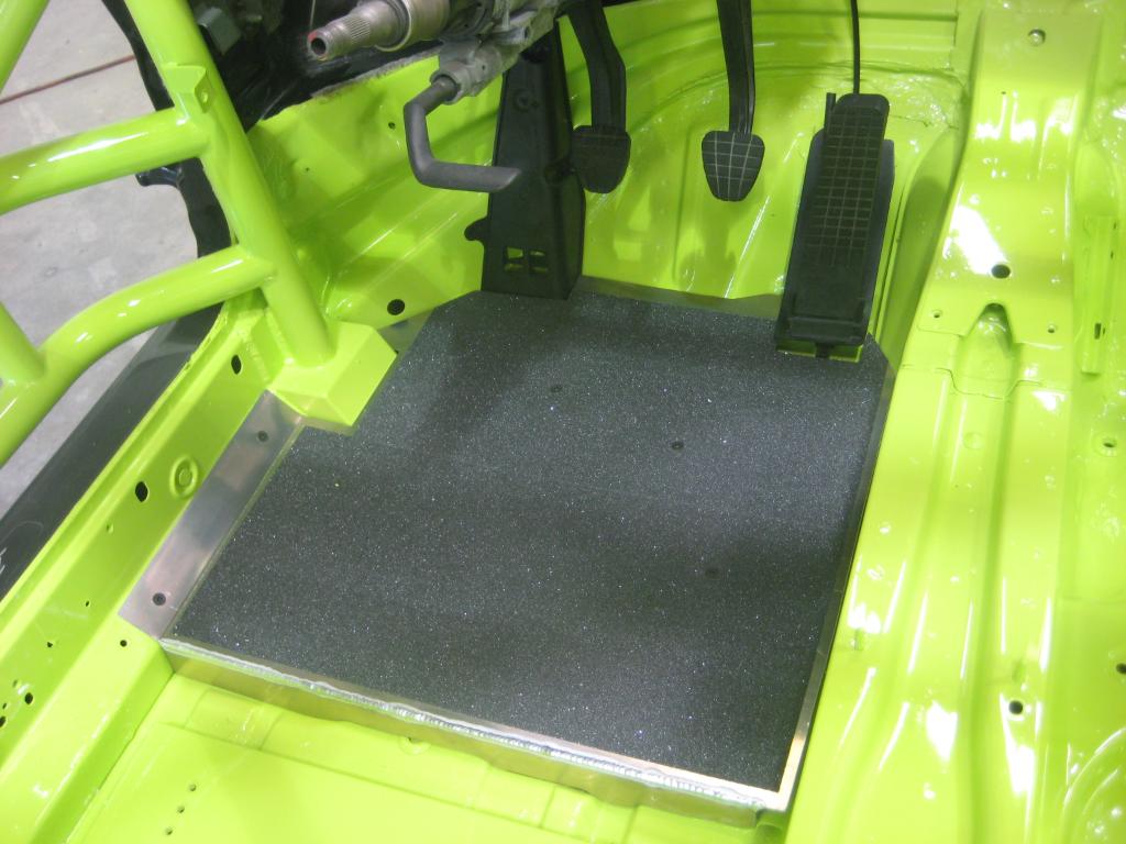

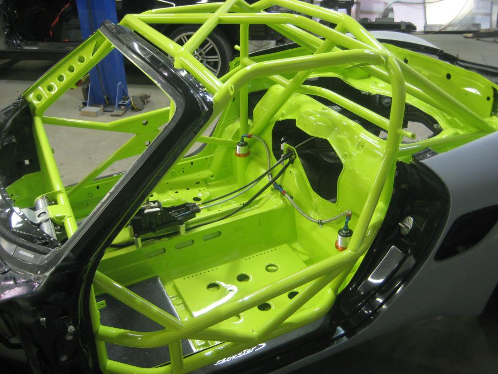

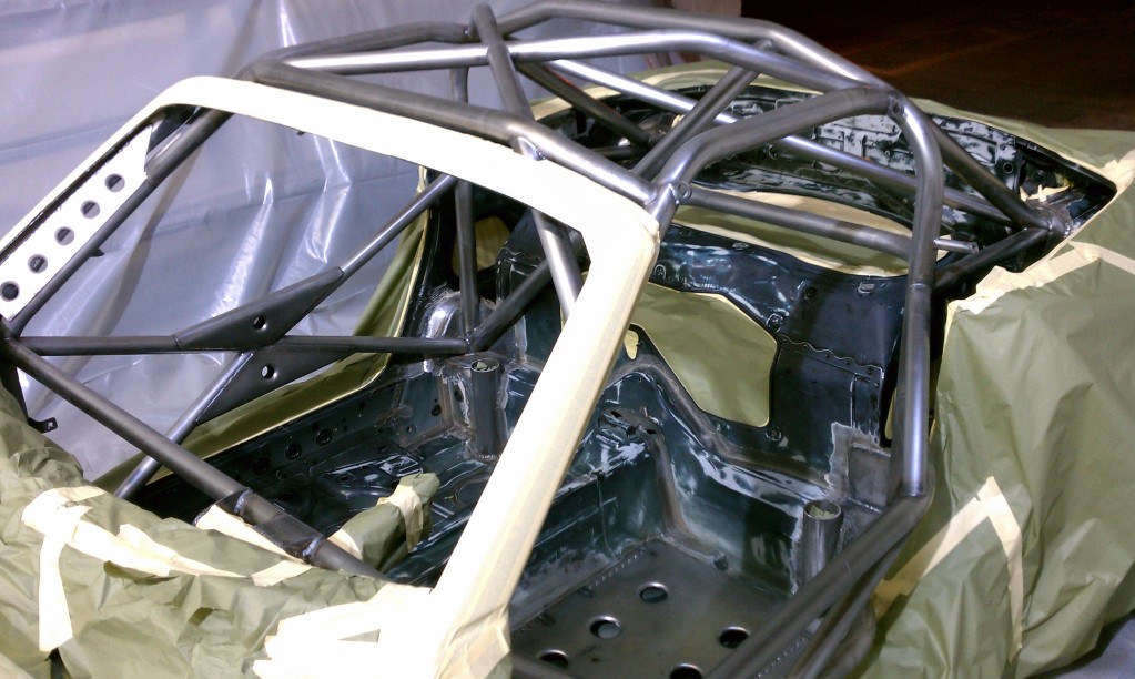

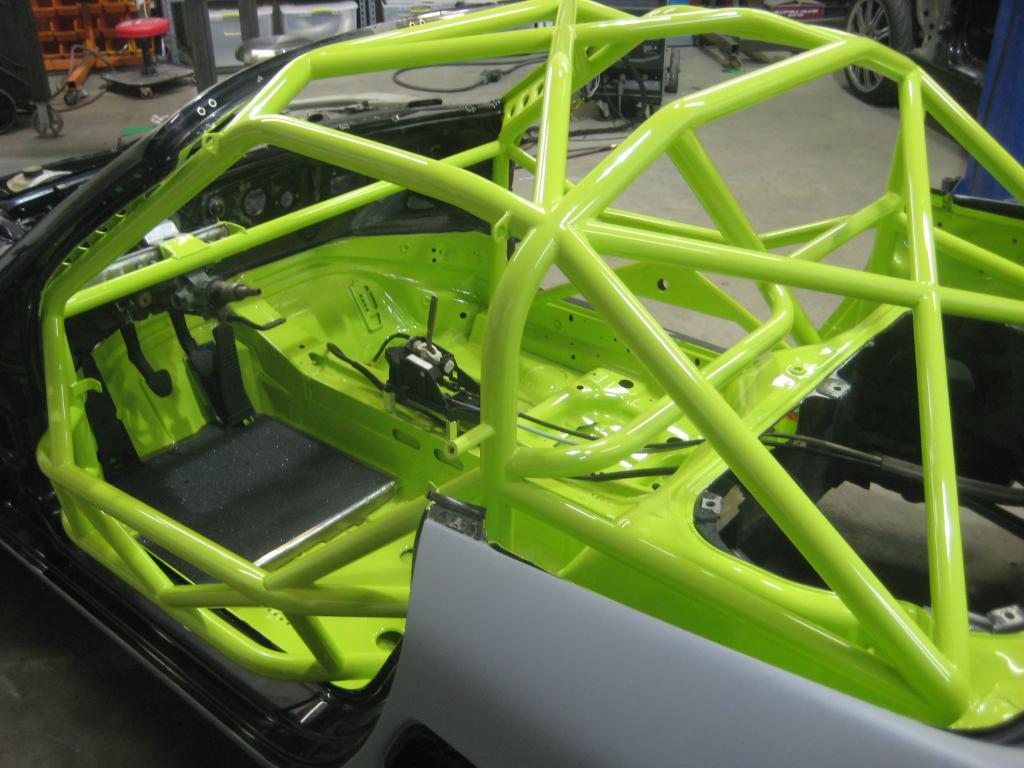

Finally started the paint process.
(IMG:http://www.914world.com/bbs2/uploads_offsite/i180.photobucket.com-11979-1308726533.1.jpg)
(IMG:http://www.914world.com/bbs2/uploads_offsite/i180.photobucket.com-11979-1308726534.2.jpg)
(IMG:http://www.914world.com/bbs2/uploads_offsite/i180.photobucket.com-11979-1308726534.3.jpg)
(IMG:http://www.914world.com/bbs2/uploads_offsite/i180.photobucket.com-11979-1308726534.4.jpg)
