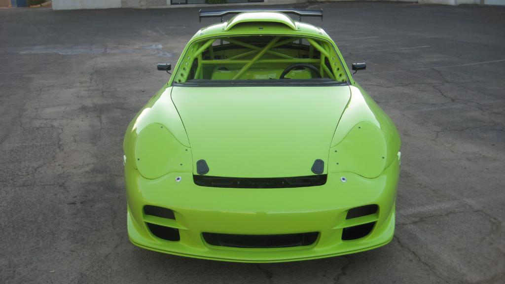

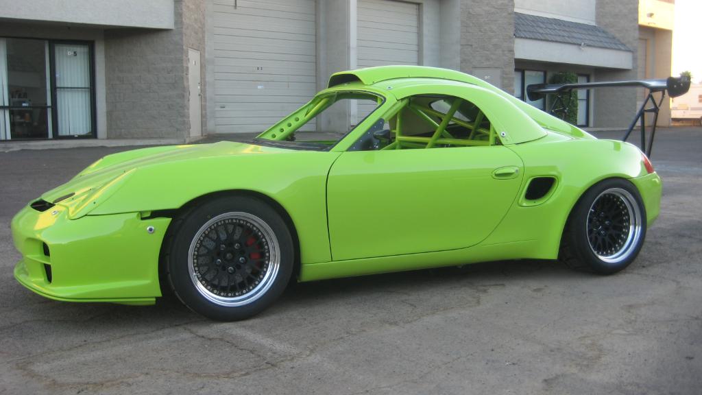

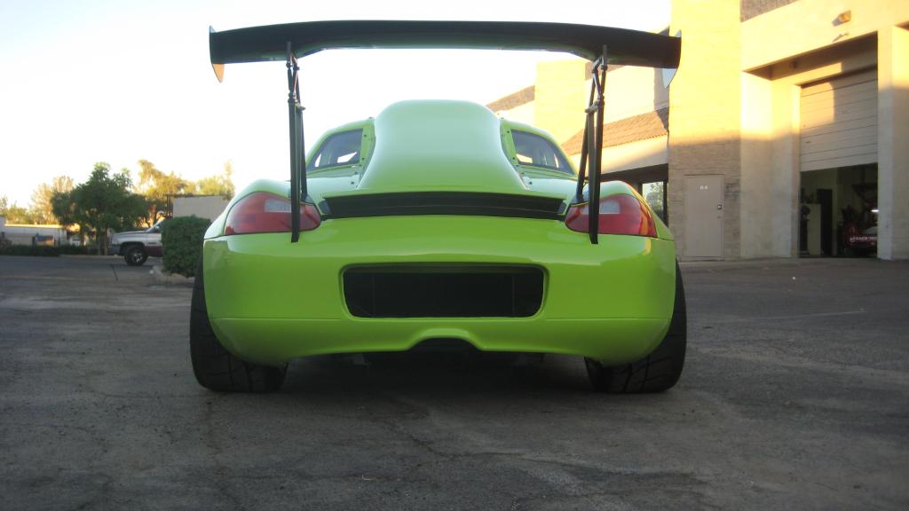

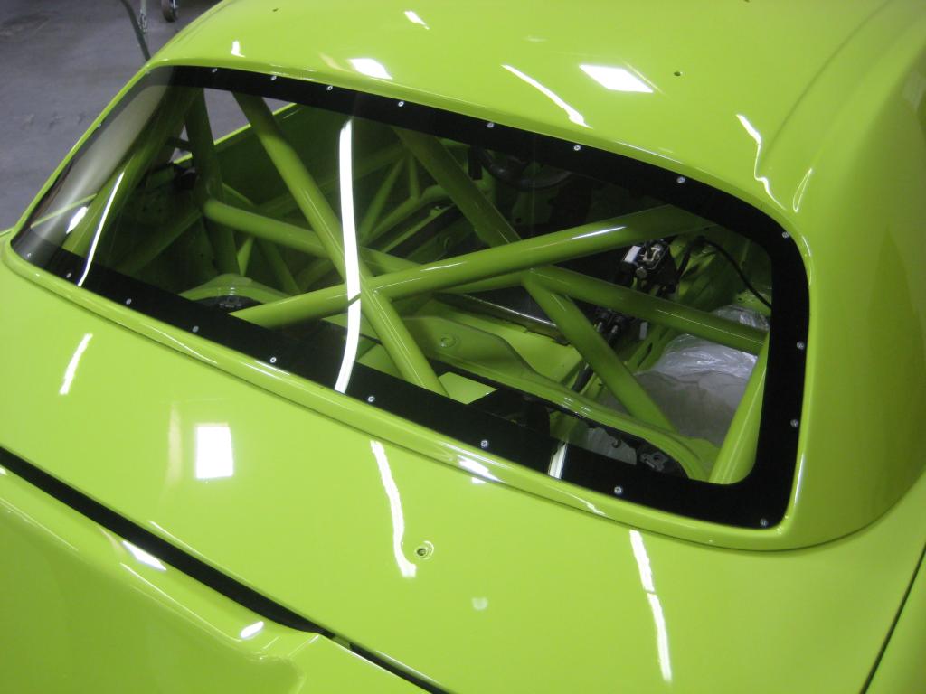

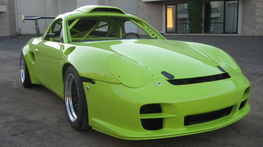

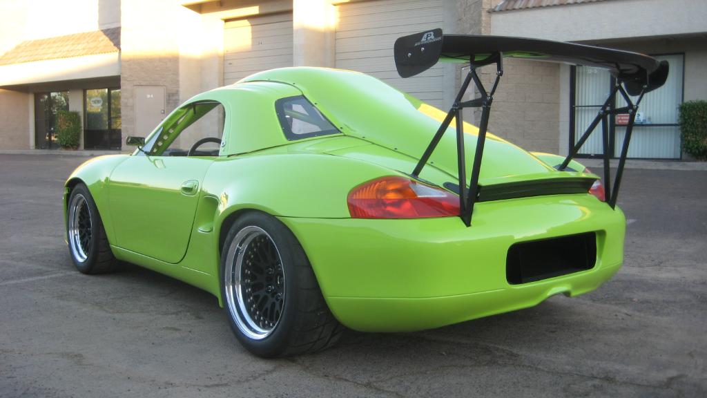

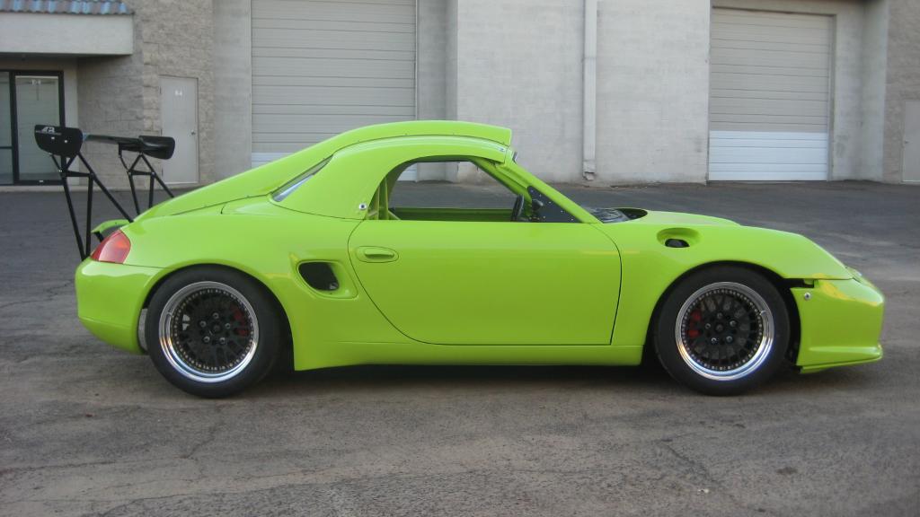

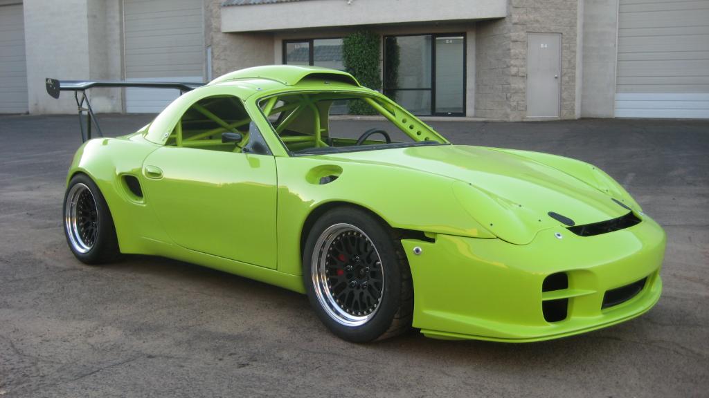

Exterior is now 90% finished. Just need to finish up a few small details...
(IMG:http://www.914world.com/bbs2/uploads_offsite/i180.photobucket.com-11979-1310786987.1.jpg)
(IMG:http://www.914world.com/bbs2/uploads_offsite/i180.photobucket.com-11979-1310786987.2.jpg)
(IMG:http://www.914world.com/bbs2/uploads_offsite/i180.photobucket.com-11979-1310786988.3.jpg)
(IMG:http://www.914world.com/bbs2/uploads_offsite/i180.photobucket.com-11979-1310786988.4.jpg)
(IMG:http://www.914world.com/bbs2/uploads_offsite/i180.photobucket.com-11979-1310786988.5.jpg)
(IMG:http://www.914world.com/bbs2/uploads_offsite/i180.photobucket.com-11979-1310786989.6.jpg)
(IMG:http://www.914world.com/bbs2/uploads_offsite/i180.photobucket.com-11979-1310786989.7.jpg)
(IMG:http://www.914world.com/bbs2/uploads_offsite/i180.photobucket.com-11979-1310786989.8.jpg)
(IMG:http://www.914world.com/bbs2/uploads_offsite/i180.photobucket.com-11979-1310786989.9.jpg)
(IMG:http://www.914world.com/bbs2/uploads_offsite/i180.photobucket.com-11979-1310786990.10.jpg)
Engine and transaxle install is next...

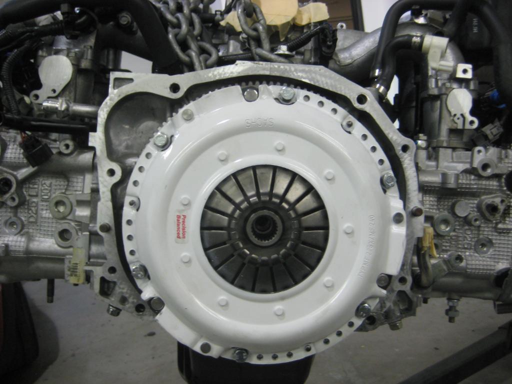

(IMG:http://www.914world.com/bbs2/uploads_offsite/i180.photobucket.com-11979-1310921148.1.jpg)
(IMG:http://www.914world.com/bbs2/uploads_offsite/i180.photobucket.com-11979-1310921148.2.jpg)
(IMG:http://www.914world.com/bbs2/uploads_offsite/i180.photobucket.com-11979-1310921149.3.jpg)

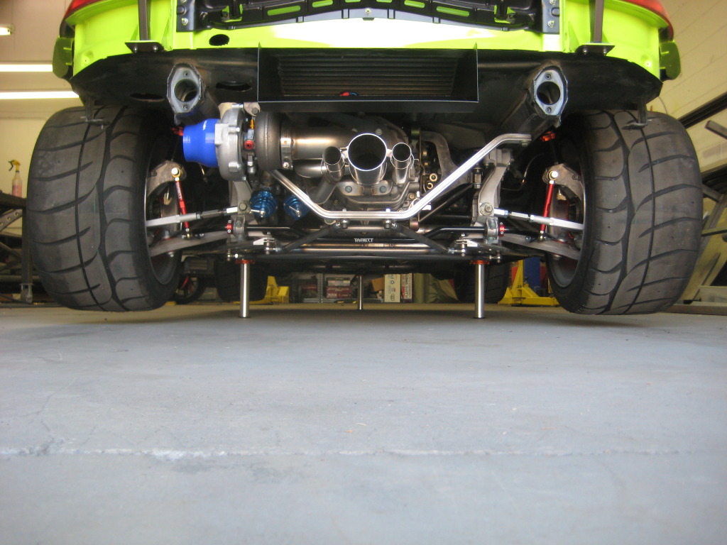

I've been working on the final assembly lately. It's basically down to some fluid plumbing (accusump, oil coolers, scavange pump etc) and finishing up the chassis harness and then I should be able to try and fire the motor. The air jacks work though...

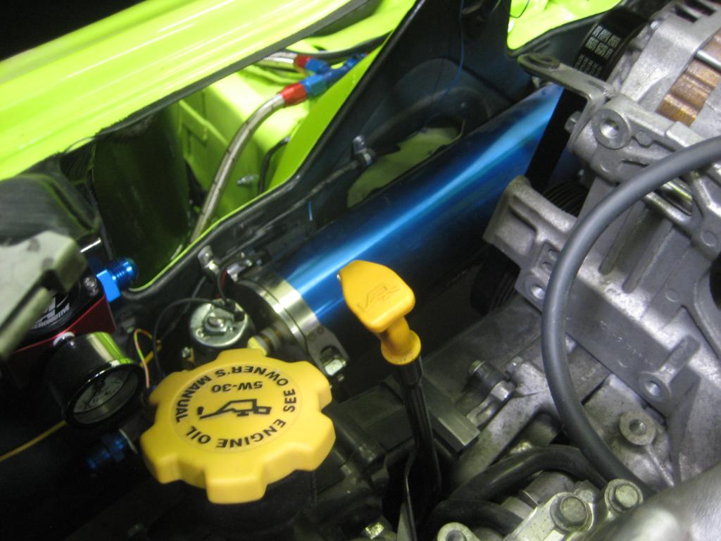

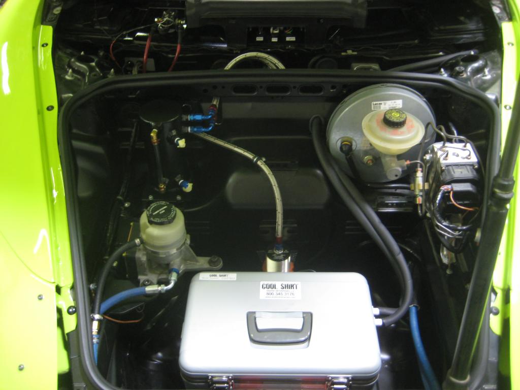

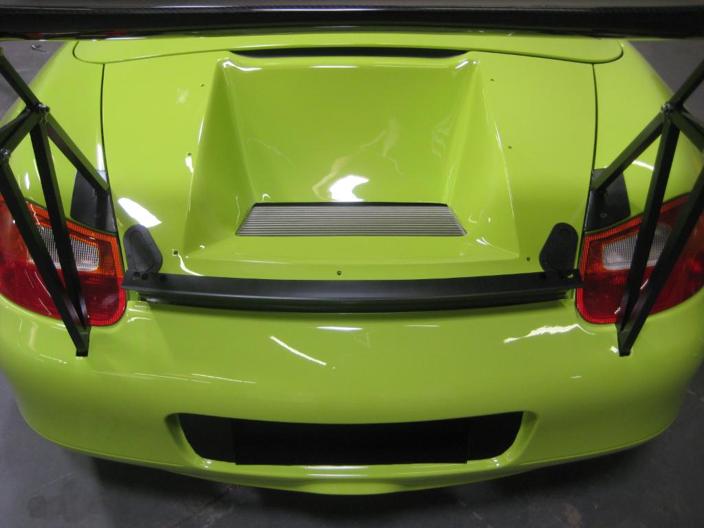

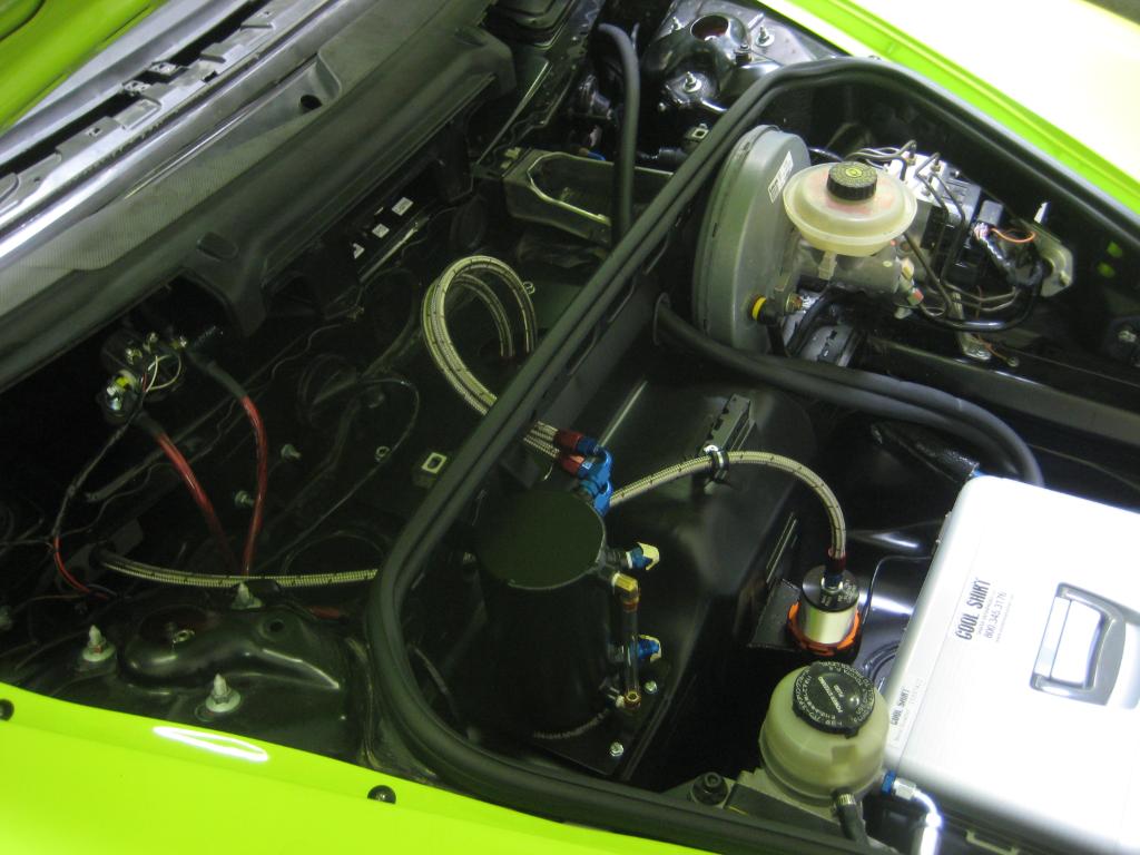

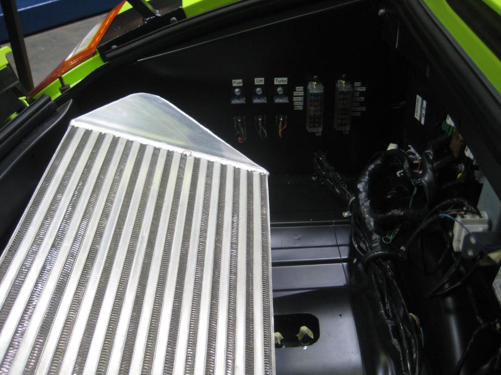

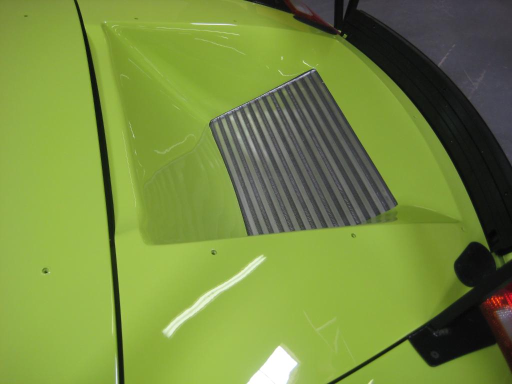

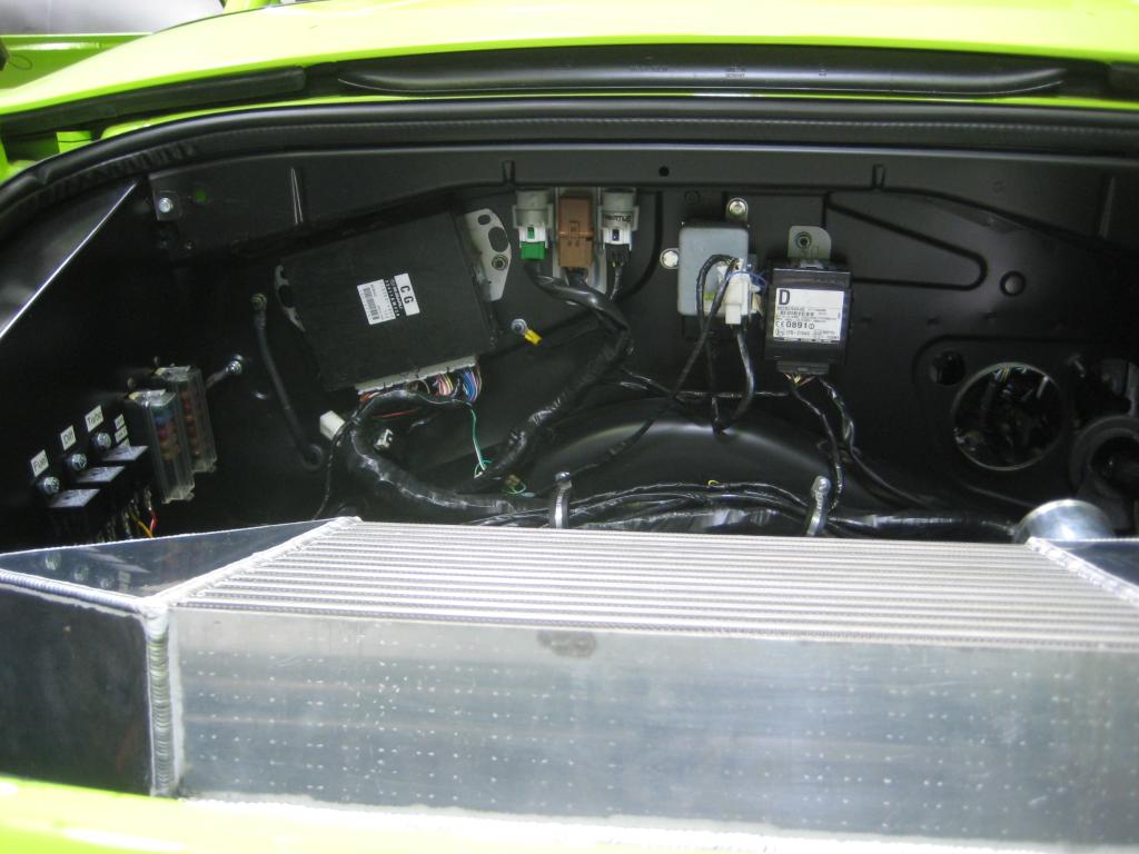

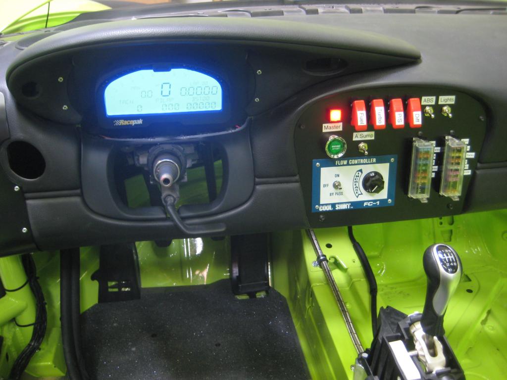

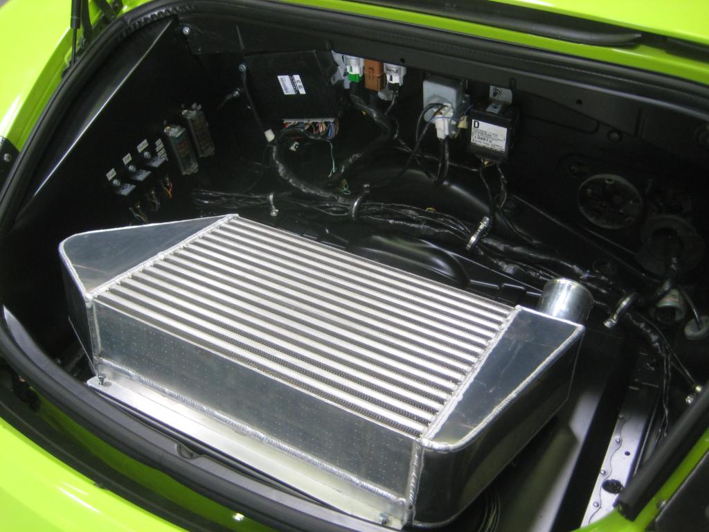

Wiring is DONE! Other than the ABS system, the chassis harness was built from scratch. The engine management is stock from the 2007 WRX donor and fit in the stock Boxster location using all stock mounting points. We were even able to use the stock Porsche ECU mounting studs with the stock Subaru ECU and relays. Everything powers up and the engine cranks. Still need to plumb the oil system, fuel system, and cooling system, but then we should be able to fire it up and get it on the dyno for some tuning.
Rear trunk
(IMG:http://www.914world.com/bbs2/uploads_offsite/i180.photobucket.com-11979-1316900634.1.jpg)
(IMG:http://www.914world.com/bbs2/uploads_offsite/i180.photobucket.com-11979-1316900634.2.jpg)
(IMG:http://www.914world.com/bbs2/uploads_offsite/i180.photobucket.com-11979-1316900634.3.jpg)
(IMG:http://www.914world.com/bbs2/uploads_offsite/i180.photobucket.com-11979-1316900635.4.jpg)
(IMG:http://www.914world.com/bbs2/uploads_offsite/i180.photobucket.com-11979-1316900635.5.jpg)

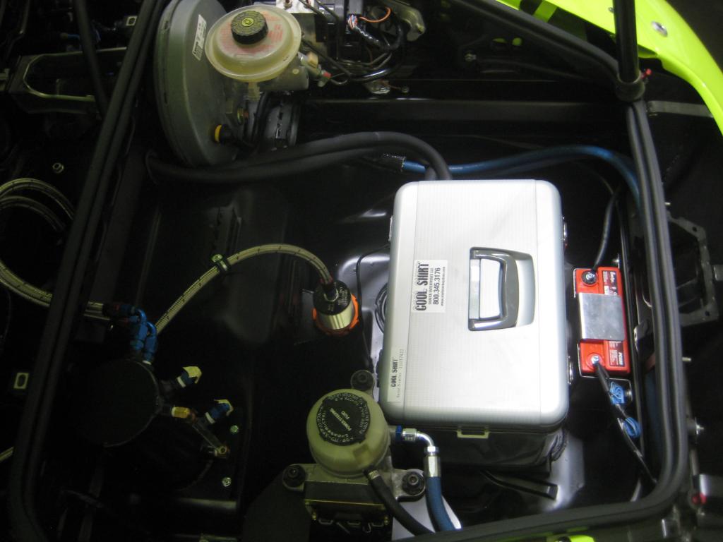

Accu Sump
(IMG:http://www.914world.com/bbs2/uploads_offsite/i180.photobucket.com-11979-1316900635.6.jpg)
(IMG:http://www.914world.com/bbs2/uploads_offsite/i180.photobucket.com-11979-1316900636.7.jpg)
(IMG:http://www.914world.com/bbs2/uploads_offsite/i180.photobucket.com-11979-1316900636.8.jpg)
(IMG:http://www.914world.com/bbs2/uploads_offsite/i180.photobucket.com-11979-1316900636.9.jpg)
