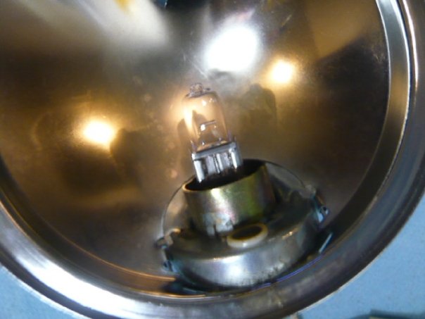

Eric_Shea
post Nov 9 2010, 10:55 PM
PMB Performance
Posts: 19,304
Joined: 3-September 03
From: Salt Lake City, UT
Member No.: 1,110
(IMG:http://www.914world.com/bbs2/uploads_offsite/sphotos.ak.fbcdn.net-1110-1289364935.1.jpg)
(IMG:style_emoticons/default/wub.gif)
