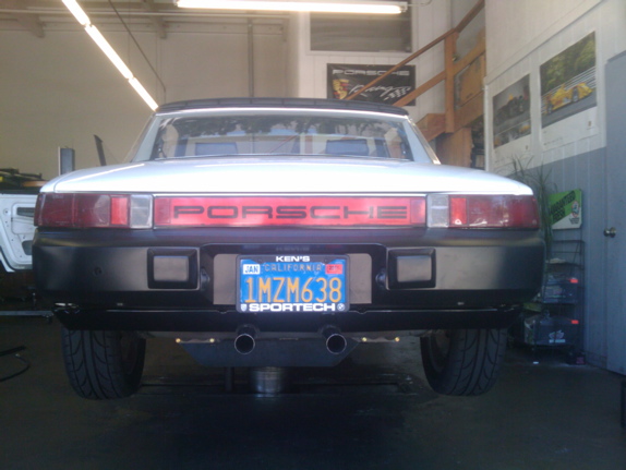

Bursch used to make and early and late style muffler
One for the early valence and the more numerous and available unit for the later valence...
Or just weld up the hole and twin pipe your stock muffler (IMG:style_emoticons/default/biggrin.gif) (IMG:style_emoticons/default/idea.gif)
