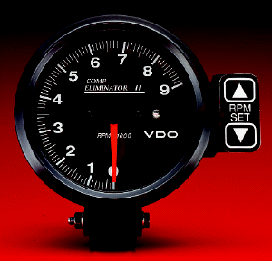

This is the VDO Pro Eliminator:
(IMG:http://www.914world.com/bbs2/uploads_offsite/www.nhspeedometer.com-2618-1281151118.1.gif)

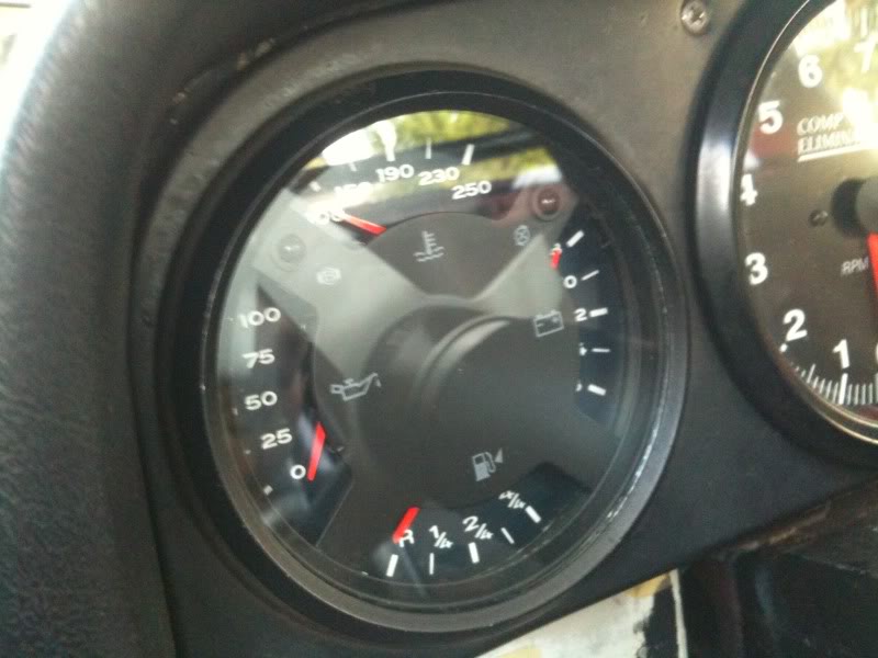

That data button is detachable and with a ribbon cable you can relocate it some place that's inconspicuous. Use the control to change shift light rpm's, replay the data log, etc. The pedestal just dismounts and it nearly fits into the 914 dash hole without fuss. Nearly, not quite. Since it's VDO the font is nearly the same as the other gauges. I don't have a good photo of the tach, but it's just to the right of the quad-guage. You can see how the bezel matches the other gauges.
(IMG:http://www.914world.com/bbs2/uploads_offsite/i379.photobucket.com-2618-1281151118.2.jpg)
It's a good match overall and will get a modern tach into the car. The needle is unbelievably steady. The shift light is just a LED, but it's pretty bright, especially at night when you're out drag racing.
