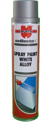

Just an update. OE steel wheels are being sandblasted and primed, then a coat of satin black on the backside, and a few coats of Wurth White (really silver) wheel paint on front side.
I ordered the paint from a California vendor, so I didn't have to content with the "can't ship into CA" ordeal.
Again, the Wurth white looks like a better match to the mid-70's vintage steel wheel finish than the Wurth Silver.
Not sure about the satin black for backside of wheel though.

Was that the Wurth Wheels White or whatever they call it? IIRC they also sell that at BavAuto for the BMW wheels refinishing (I have an 85 325e).

Hey Tom,
Yes, I checked the O&H wheel post and that helped me decide to go with the White Wheel paint instead of the Wurth Silver.
Spoke with Terry at Goodspeed Motoring and he recalled using the Wurth White on a 80's Volvo with good results. I researrched that finish, and to my eye, it looks a lot more like what I think the original steelies look like.
So, I ordered 3 cans, (they are huge) from Goodspeed.
I can't wait to get the wheeels back to give this a try.
(IMG:http://www.914world.com/bbs2/uploads_offsite/img.photobucket.com-10656-1282768398.1.jpg)
That "White Alloy" name sounds like some of the German-to-English translations of parts names in the Porsche 914 PET parts catalog - like "desk pad" for the side mirror base gaskets! I guess the Asian translated electronics manuals aren't the only ones with strange translations! (IMG:style_emoticons/default/biggrin.gif)
I think that's the one recco'd for my painted alloy wheels on my BMW too.

Hi!
Yes the colour is a european colour code RAL 9006.
It is standard paint on many german cars.
You can also find it on ebay.de search for RAL 9006.
